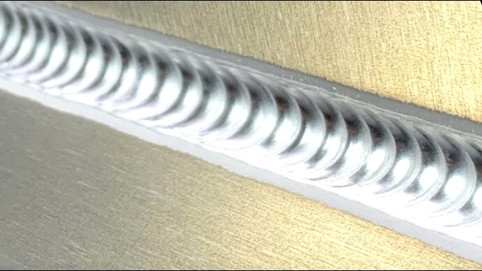

I want to share a relatively easy way to draw Tungsten-Inert-Gas welds. The technique could also replicate MIG (Metal Inert Gas), with some adjustment. The technique could theoretically be automated with Grasshopper, or a Rhino command. First, let’s see the results…

In TIG welds, daubing the weld puddle with the filler material gives this real-world effect, seen in these four following pics of real welds–not my technique.
