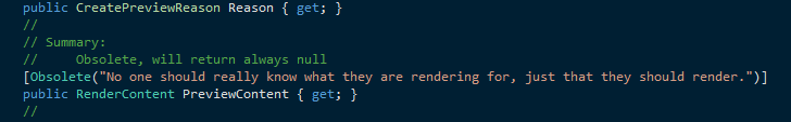

So I am looking to be able to get the scale I need from here:
I am guessing I might get this value from RenderMaterial.DefaultPreviewSize, but the sdk says I don’t need to know the material for which I’m rendering a preview:
Maybe I can find out by looping the provided SceneObjects and finding one that matches CreatePreviewArgs.ContentTypeId, but besides this seeming quite a hack, there could be more than one that matches. And that is assuming that RenderMaterial.DefaultPreviewSize is really what I’m after, in the first place.

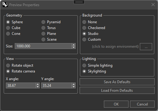

I see the youtrack now says that preview scenes are always in meters, but this is troublesome given the default preview size of 1000 (this is by using file > new > no template):

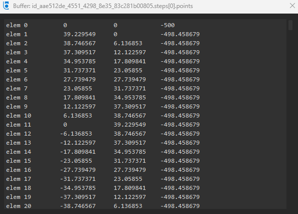

if the scene is in meters, that yields a 1km sphere (these are the actual mesh points):
so even reducing the preview size from 1000 → 1, which most users are not aware they can do at all, we will still end up with a 1m sphere (actual mesh points ranging from -0.5 to 0.5), and lower than size=1 is not allowed

That is because by default with no template the model unit is mm, so 1000 units.
When you start a new file without template, change the model unit to meter, then add a new material. Right-click the material thumbnail and open thumbnail properties. You should find that the size is 1.0
edit: Also, changing model unit after you have added a material you’ll find that the preview unit count has changed as well. After adding the material in a meter one, changing model unit to mm you’ll find that preview size is now 1000.0
yes, by default for a mm doc we get a 1km sphere, while for a meters doc, we get a 1m sphere
No, the preview size is 1000 units = 1000mm = 1m.
