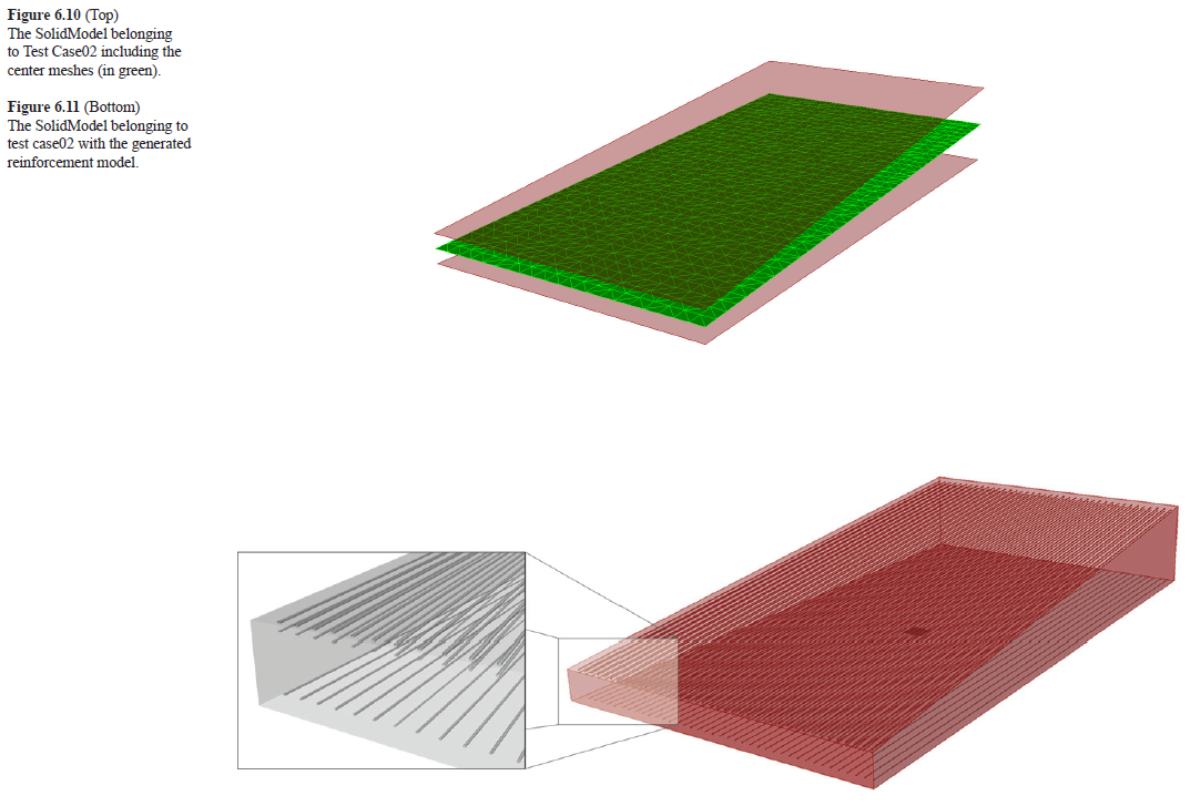

Now I have a more complex project. I need to develop a “toolbox” for an engineer to start from its calculation results (.TXT files) and create with rhino a parametric reinforcement model of a building, and then export it to TEKLA, for draftsmen to take over detailed drawings. See above for more details.
What kind of help do I need
I want to make sure I use an appropriate dev environment. In other words, can I just stay with separate scripts that I load one by one, or should I move to real dev environments, using Visual Studio for example.

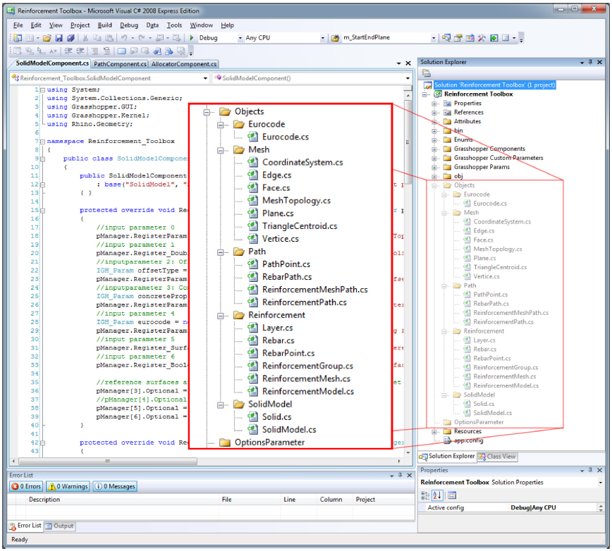

I have never used Visual Studio but I looked at what other people did with it and it looks good :
https://repository.tudelft.nl/islandora/object/uuid%3Ab41a1e0f-d885-4bea-910f-0b80e8020f74
However, I am bit afraid of loosing time on learning new langages (other than RS and Python) that would slow my dev, and I really need advice from experienced people Here. Is it worth it ?

Here above are the first scripts, just to give you a hint :

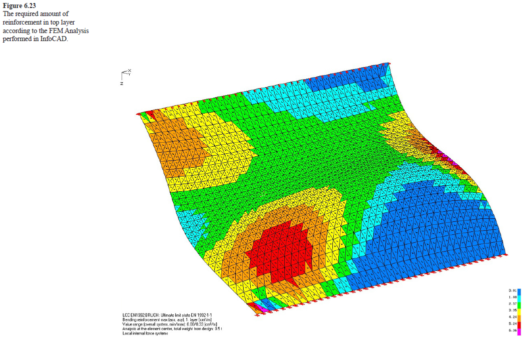

0/ INPUT
This is just .TXT files containing a mesh and calculation results at mesh node points.
Script 1/ INPUT VISUALIZATION
Visualise the mesh and the results in Rhino. This is fine with RS or Python.

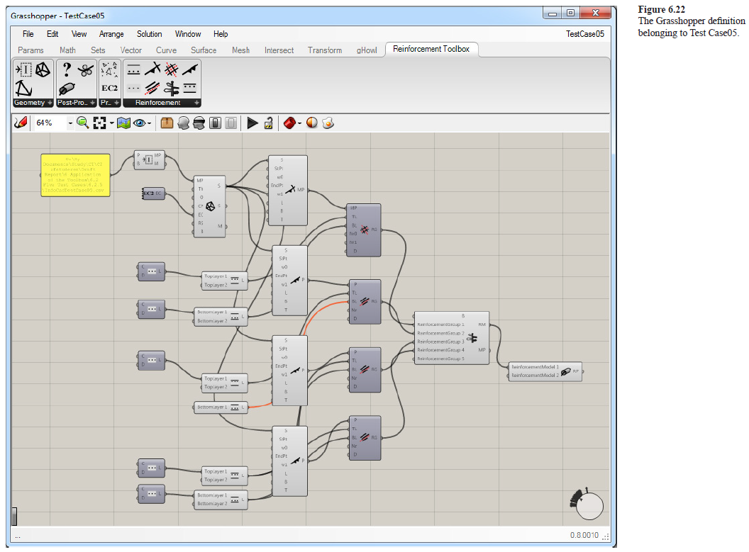

Script 2/ CREATING PARAMETRIC REINFOCEMENT ZONES
This is creating series of bars. For example you create a polygon on your mesh in rhino, and then the script asks you a few parameters (bars spacing and diameter) and creates a layer with your serie of bars.

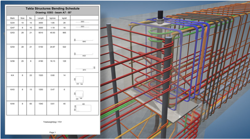

Script N : Many other functionalities, ending with reinforcement export to TEKLA

Actually, I think I just need a good tutorial to get me started with a real dev environment (VisualStudio?), and wether VS can tell Rhino to execute scripts in Python, VBScript… This is why I was happy at the beginning to just deal with Rhino and execute a .rvb file. But now that things are more complex, I do feel the need of a proper dev environment…
Am I correct that it’s ok for you to learn a new language for it? Just in addition to python and VB, c# could be another option. If so, Long’s tutorial is a good place to start (c# + VS).
Personally I also enjoy VS together with gh python’s code input. It’s like a live link between VS and gh.

This is indeed a problem regarding the Rhino environment. So first of all if you download Visual Studio 2017(!) you can download a so called "Rhino Wizard" from the marketplace which setups a Rhino Project for you. There is no template for VS 2019 yet. (At least from what I know). But in theory you can setup a project for yourself. This however requires some experience with Visual Studio.
There is currently one limitation using Visual Studio, which requires you to restart Rhino for any change to apply. However there are workarounds as well. Maybe you just start getting used to Visual Studio, creating a console app and a .dll at least once. There are plenty of tutorials on the internet. As I said it will be overwhelming in the beginner, but once you get a clue about how to use an ide like Visual Studio you won’t move back again.

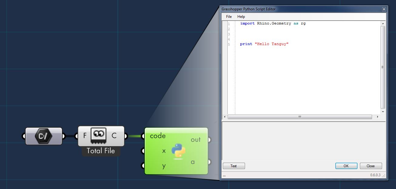

@tim.stark : Hi Tim, If possible, could you give me some more details about this method ? Are there any tutorial or general documentation that you would recommend to get me started with the VS / Python method ? And how does it work for the user ?
I don’t have much time to make a video or something like that, but I try to describe it as good as possible.
First of all you need to install python and the rhino api in visual studio.
Now you can code in VS and safe it. For example:
vs1
Go to GH and place the python component. Right click on the symbol and choose: “Show code input parameter”. Place a “file path component” and “read file” (total file) and connect it:
“Set one file path” to the previously in VS saved python file:
vs3
Now your python components reads everything you write in that file:
As soon as you safe the VS python file, the gh python component gets updated:

You are right, he’s just changing the editor. But he could use it to easily debug and if he finished everything he could still create a plugin with the rh6 python editor.

All you need to do is downloading Visual Studio and these templates (they are also runnning on vs2019 now):
https://marketplace.visualstudio.com/items?itemName=McNeel.RhinoCommontemplatesforv6
https://marketplace.visualstudio.com/items?itemName=McNeel.GrasshopperAssemblyforv6
They already include an example each
This is the Rhinocommon api sdk:
https://developer.rhino3d.com/api/RhinoCommon/html/R_Project_RhinoCommon.htm
All you need to do is build and run
