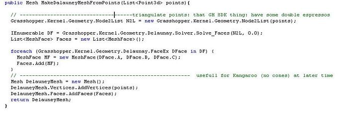

Interesting to stumble on this today. In the past, every time I’ve ever researched this stuff for different projects, I’ve also wanted to do ‘volumetric’ style delaunay/voronoi geometry.
But all I ever see is ppl only doing it 2-dimensionally along a surface :sleeping:
I have some stuff I got from @DanielPiker , but I think there’s still improvements that can be made. :beers:
When I get back into this soon, this is close to where I will pick up:
