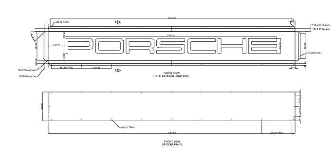

Hi community, does anyone know how I can increase the resolution of my rendered image?
When I try to render my dimensions and text of a 2D drawing when I open the image it is fuzzy/blurry.
I need it ti be sharp. How can I fix this?
Even when I try increasing the DPI and saving in various formats i.e. png it still doesn’t help.
