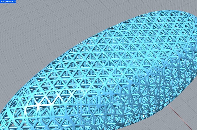

Hey so I’ve experimented with both workflows with this design I put together quicky. The goal to see how much detail each style can pick up,
@laurent_delrieu This style has the ability to capture a lot of detail, however it super heavy on the computer because of all the tri’s it creates to make the mesh. I should have gone smaller with the pattern but it was taking a lot of time to process. However, I like how you can go through different lattice styles with this route.
@porterfield.aaron This workflow was very smooth and much lighter on the computer in terms of processing. However, because it uses the tri-remesh function, a significant amount of detail ends up getting lost. It is fine, but something to keep in mind when working with it. It is also limited in its style to this one type of lattice.

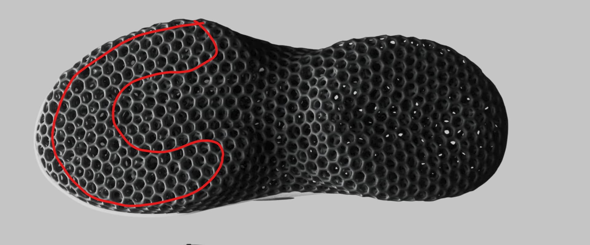

I do have one last question, is it possible to parametrically make certain areas of the lattice thicker or more filled in compared to other areas.
See image below, if I could fill in this area more through grasshopper it would provide a lot of flexibility. Especially if you want to make one area more dense for added support and less dense in another area.
Again thanks in advance for all the help!

Hi there. Yes triremesh will be a limitation. Its better if you can make an adaptive mesh. Try remesh by color. Also tetgen has the limitation of only changing density based on the surface mesh.
In terms of lattice, there should be a slider in there for 7 different types.
To make parts denser, you can do that with either an adaptive mesh, or by varying the beam thickness. You can try using some of the crystallon tools with dendro.
