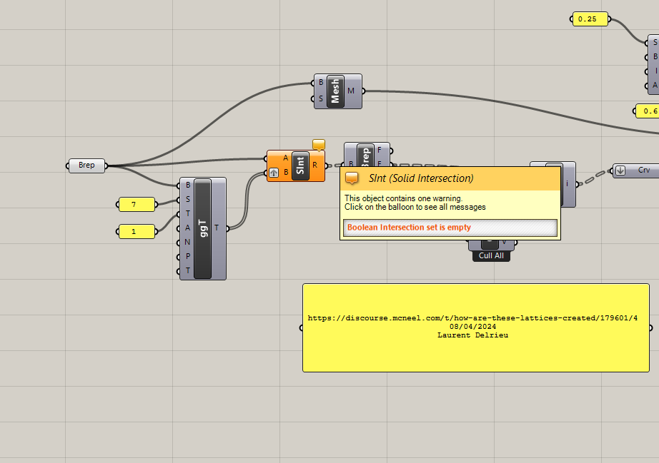

@laurent_delrieu Thank you for your input on this matter. I am currently working on a similar project. Do any of you get this error message too (photo attached)? How do you deal with it?

Hello
Hard to say
Is it a published script?
If yes where ?
Did you change the Brep?
Did you try the intersection on rhino?
Which version of Rhino ?
Did you try changing tolerance ?
Is Brep closed ?
So many unanswered questions because there is no script with data !
Thanks for the quick reply. I am sorry, attached my file. I am working with Rhino8 for a project at uni.
PUCK_Volume_MM_15erZelle.gh (20.5 KB)
Probekörper_PUCK.3dm (812.8 KB)

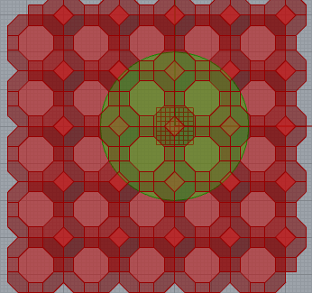

No need to deal with it, it just means that Geometry Gym tool is making geometry that are not touching the Volume/Brep. It is better like that because it means you will be able to fully cover the Volume/Brep
In green the Volume and red the geometries made by geometry gym.
