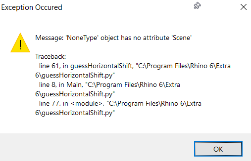

Only one problem - I get error messages. I tested it at Rhino 6 and 7 and it works at Rhino 6, but not at Rhino 7.
It should have nothing to do with the update I made, because that part of the code has been left unaltered. In fact here it works in Rhino 7. What V-Ray version do you run in 7?
I think you have your render engine not set to V-Ray but cycles :wink:
Oh, right, I have overseen that I disabled V-Ray for my Bongo 3 project. Thank you for point it out. :slight_smile:
