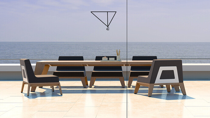

As for horizontal/vertical shift, see this example. In this case I rendered the view much wider and cut of the right part of it. So basically it comes down to shifting the camera sensor relative to the lens

so does that mean we can expect sensor shifts both horizontal and vertical? That would be really welcome. This not only comes in handy for the look I posted above: Sometimes after a rendering has been made, during composition you notice that you had wished a bit more room at one or more sides of the rendering, but you want camera location /direction/resolution to stay the same. In other words, we need a ‘crop’ outside the area of the camera sensor.

true, but it’s a little different than what would be ideal. Current implementation is more like vertical perspective correction. When sensor shift would be enabled, this vertical lens correction isn’t strictly necessary anymore, we can keep the camera Z and target Z at the same height and solve the rest by shifting the sensor relative to the lens. For best experience though this should be integrated into the camera view otherwise it’s difficult to see what you will end up getting without doing a preview render.
