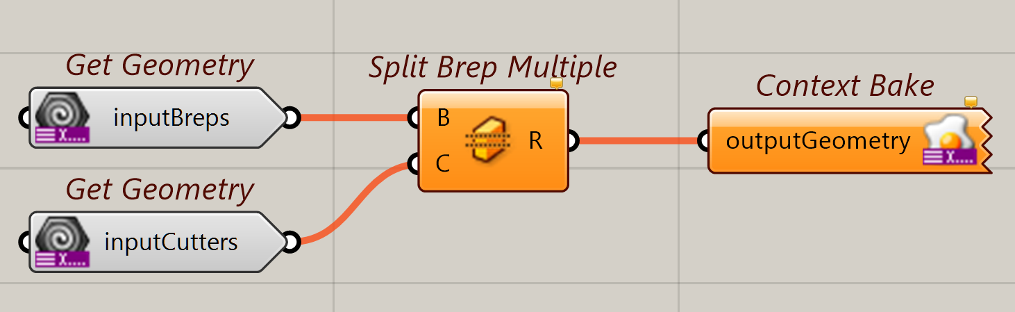

It showed a distinct Tree input access, but perhaps it was later removed? Nonetheless, what is the proper way of setting Tree input when using Hops? I am testing Split Brep Multiple component, but it will flatten my input tree structure as shown in the screenshot. I am expecting a tree with three branches, two Breps in both.
The GH definition is set up as follows:
I am using default At Least and At Most settings which are 1.
What am I doing wrong here?
You need to update your Rhino to service release 7.19.22130.15001 and/or 8.0.22131.04306 or higher. Once you’ve updated Rhino, all of the contextual Get components should have a Tree Access input.

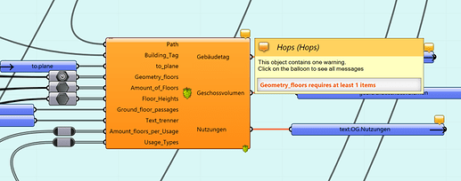

Hey all, I just updated for the hops 0.15 version and that broke my hops components. I have noticed that just one of the inputs (a get geometry) was always saying “this input needs at least one item”. But I was putting one or more itens (as list) and I also had no maximum for that specific input.
What solved the issue was to put tree access as true. I just wanted to point out that before the list access was working without that. Is that to be expected?
Hi @natasha.catunda This is a bug that was just fixed in the latest release 0.15.3. Could you try upgrading to that version and see if that fixes things?
Hi @AndyPayne
Not really. I actually noticed I had that version already, cause I literally just updated hops. Anyway I tried to reinstall everything, reboot etc. I can again reproduce the issue: if I put tree access to false (images below), then I have an issue, if true, it works again.

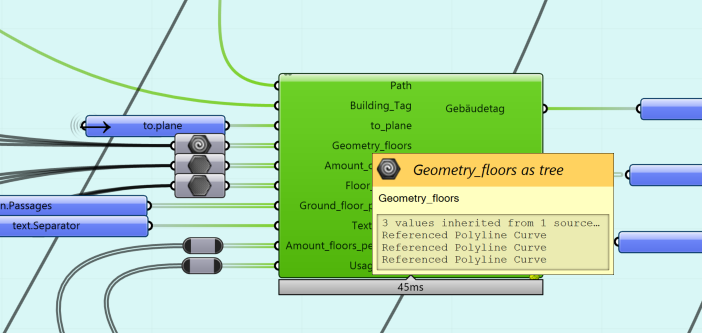

What is weird is why the problem comes ONLY with this input. I have tried to put any input component and it comes the same issue. I have another “get geometry” that has absolutely no issue with the list input. The only difference between the two of them is that one is a list of polylines and the other a list of surfaces.

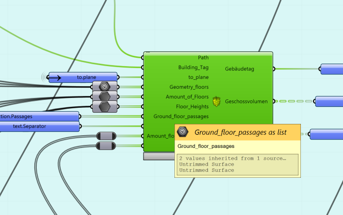

Here the other “get geometry” that is working with a list input:
But this one needs to be a tree:
