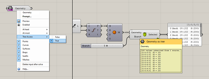

DataTrees are now supported in Hops if you are using Rhino builds >= 7.19.22130.15001 and/or 8.0.22131.04306. All of the contextual getter components in these Rhino builds now have a menu item which lets you set whether you want that parameter to have DataTree access. When set to true, this setting will override the
AtMost
value which is what Hops uses for item or list access. The DataTree access setting will have no effect if you are using the GH Player command. -
