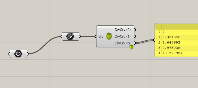

  • Components can now be outputs
    Previously only params could act as outputs. Now any component that is grouped and named using the RH_OUT syntax will act as an output. In other words, this:
    becomes this when referenced by hops
