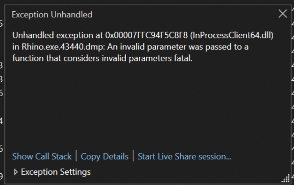

When I opened the .dmp file I got this pop-up
Looking at the callstack and the threads I can see that the crash happened in the main thread
The callstack indicates InProcessClient64.dll
