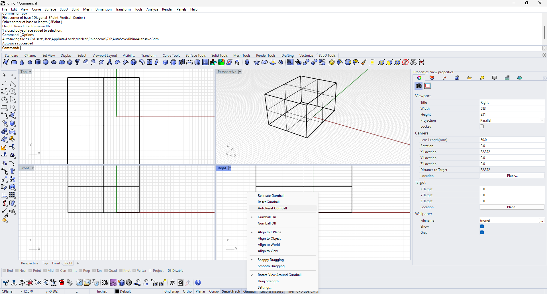

I relocate the Gumball on my object because its current location is gibberish.
But when I deselect and reselect the gumball forgets I had relocated it and its back to gibberish.

Hi, no I don’t.
interesting-
run the systeminfo command in rhino and and post results here.
gumball should stay put unless you have autoreset enabled.

I noticed it happens on a model with many things. If I copy the part I am relocating the gumball into a new document, it stays.
so this is not a consistent behavior?
can you outline when it happens with steps to repeat? I’m not able to repeat this here. I have to specifically reset my gumball once its been relocated.
No steps involved, just working on a model pasting a bunch of geometry and doing kit bashing.
I actually copied a big bunch now and it does happen in a new document consistently.
I have uploaded said model to support, can you see it Kyle? Thanks.
Hello - just in case - If mulitple objects are selected, Gumball cannot remember the relocation.
ah, ok I see what’s happening
your object is a group. If you make it an object and not a group you can relocate and it will stick.
