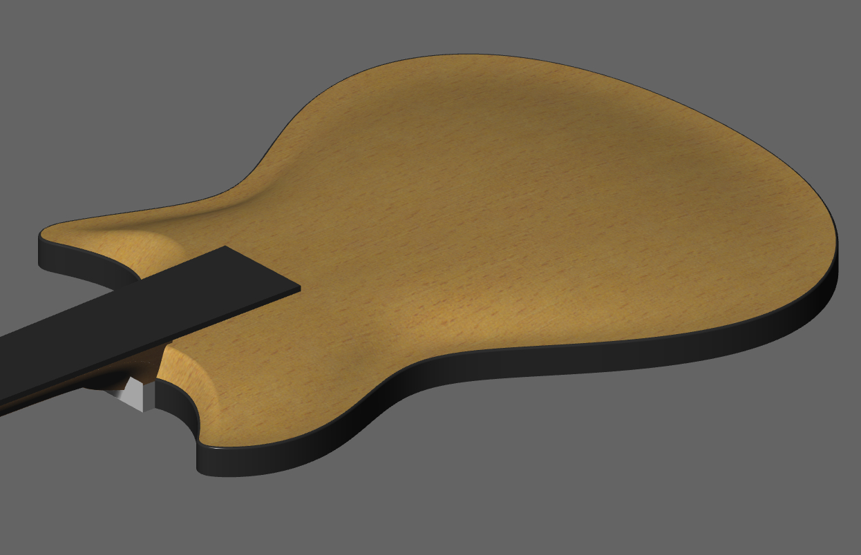

I finally had some time to work on this again. I believe I’ve made some progress using various tips gathered in this thread.
Essentially, I’ve manipulated some of the reference lines. Seeing as my measurements from the actual instrument weren’t perfect, I’ve afforded myself some artistic license.
I found the best result for my intersecting curves was to use @markintheozarks advice with a 3-point curve trimmed to my reference points. I then drew a line to zero out my curve at the perimeter line and used ‘curve > blend curve > arc blend’.

Not sure if this is the right way to do it, but I tried the patch command and selected everything, then trimmed off everything outside my perimeter… seems to look okay. Open to feedback on this.
Patch only on the outer border curve and the middle profile.

Hi Mike - for what it is worth, I’ve found this surface layout to be pretty good for these designs:
Sure. Here is the Rhino 5 version. For the “Patch” command I used the blue outline and the green curve across the middle. Then I additionally split the patch surface with the red curves to get the shape you were looking for. Note that the border is not perfectly leveled, so there may be some areas that are a fraction of a millimeter raised above the ground level. But that should not be a problem when you combine that shape with the vertical extrusion that will form the thickness of the guitar’s body. :slight_smile:

I’m just trying to get my head around what you’ve done (looks great!). So, you just ignored the intersecting lateral curves (not required?) and patched the perimeter w/ the centre-line? From there, I guess it’s just a matter of an extrusion on the cutaway portion of the curve (red line) and then a split? I tried to do this and notice I had to extend the red line slightly past the perimeter in order for the split tool to work (perhaps you can let me know if that’s the best approach or if there’s a ninja trick to do this differently).
As an aside, in my other thread, I have a new file I’ve been working on (same project). I’m just wondering if that would have been a better reference than the file in this thread - not sure if you have time to take a look:
Back_Recurve-TEST-JAN2020-V2.3dm (3.3 MB)
In the version you sent, I notice you’ve mirrored the perimeter to make a non-cutaway (or maybe I did that - lol - it’s been a while since I worked with that older file). Do you find that to surface this properly, that it’s better to have a non-cutaway version and then subtract it? I assume that is what you meant by “…split the patch surface with the red curves…”, which is what I did in the above screenshot.
Again, my more recent model may be more true to form (or at least have a better shape) as I borrowed the arch lines from a 17" archtop DFX file I found online and scaled / adjusted them to fit my shape.

I think that first you have yo focus on cleaning up the border curves, because I noticed that they have some tiny sudden change in shape here and there. Like this example below that shows a tiny separate curve (probably a blend curve) connecting the main red curves:
