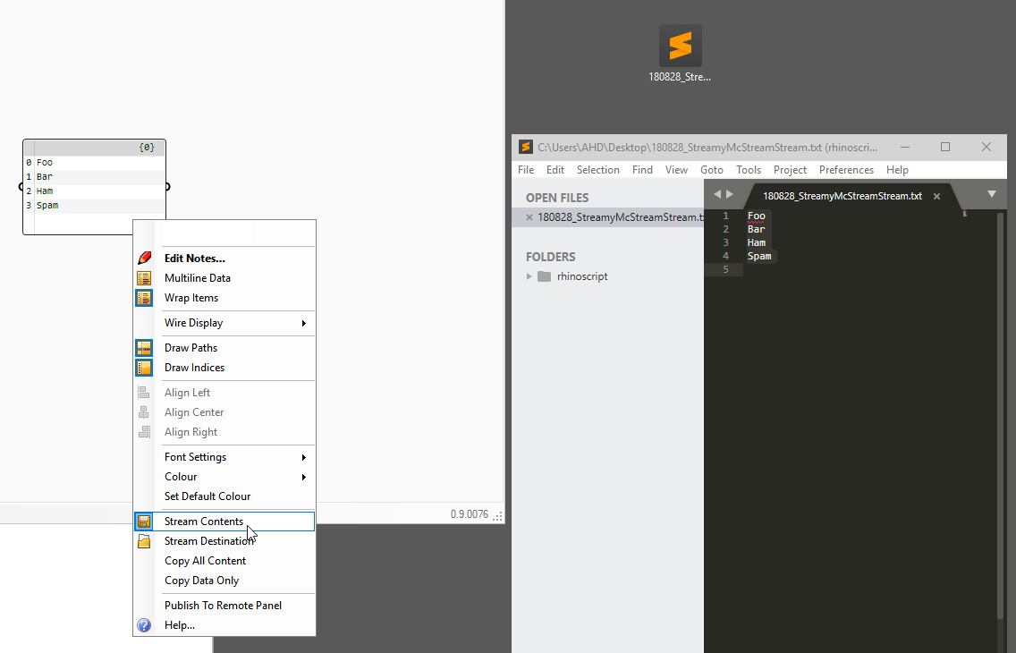

Stream it to a .txt or .csv file and read/paste this in Excel:
