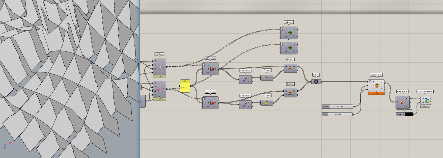

I am having an issue when I try to make an automatic waffle with the grasshopper file (attached) that I found on the web.
When I set the distance between sections in 200mm, I find I mistake that I don’t know how to solve, because instead of having all closed planar curves, it appears one “closed curve” that makes trims fail. This doesn’t happen when I set the distance in 199.9mm.
Could anyone help me? I don’t know if the problem is in the 3d geometry or maybe there are other different grasshopper operations that could avoid this issue.

Use Region slits is better

Thank you so much for your time and for the grasshopper file @anon39580149.
I just tried it with another file and it works fine, but I had to move one of the section’s group just a few milimeters down (just before the slit operation) to be sure that all trims were up in one section’s group (YZ) and down in other’s (XZ); otherwise, I would not be able to assembly them from above and I would have to bend some sections.
I attach a screenshot to a better understanding.
And this is how the trim looked before:

Try with Opennest it also have Region slits, it designed for this things
