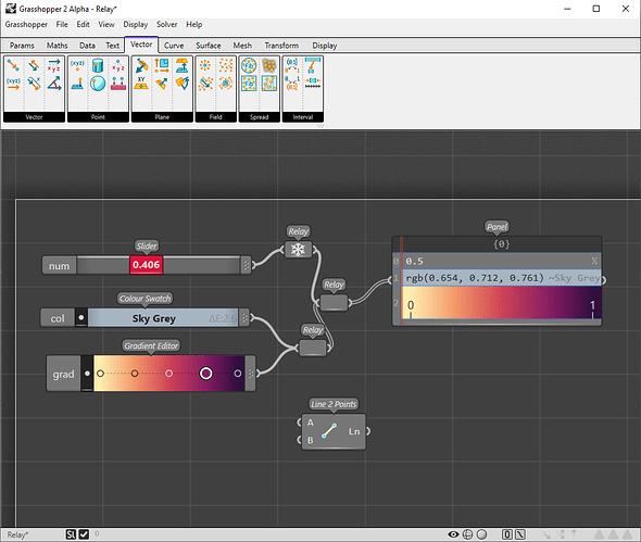

wow the new gradient editor is beautiful and diverse. now false colour images can be more than
thanks @DavidRutten

David,
this is just awesome. Playing around with it. Question to the panel element.
Does this allow now to embed any type of control? That would be great - a resizable control to host for example GridViews or whatever.
I cant figure out, how to get values into the panel itself - double click doesn’t seem to work.
Kindest
Christian
Hi Christian -
I might be misunderstanding your question but the panel only displays data, it doesn’t let you modify it.
