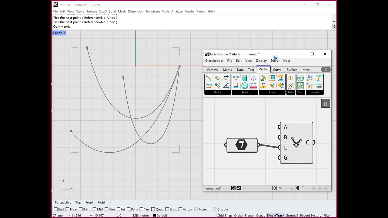

I tested with a self-made plugin, which uses data types outside of those of Grasshopper. Works just fine and I get the results I expect. Here’s a screenshot of the interoperability of GH1 and GH2:
Only the non-vector icon graphics reveal the GH1 components. This is beyond awesome!

I guess I’m missing something, I have this version installed:
And after drag and drop of Catenary I got this:
2022-04-07_13h56_34
Can someone help? :smiley:
Hi Wojciech -
Which version of Rhino are you running?
Yeah Wim, that was it :smiley: I thought I have up to date version as I checked “Check for updates” and there was green mark with “The Rhino is up to date”, but after I reinstalled it with version from 05.04 everything works. Thank you :slight_smile:
