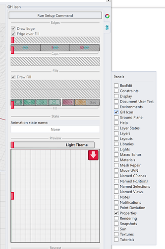

My new question is that on Windows, the panel that Rutten suggests ‘GHIcon’ doesnt exist, instead there are a couple, the most promising is (off the top of my head), G2Coder, but doesnt give you the sweet GUI. any tips on how to get this?
I’ve also noticed that setTwig() doesnt render, worth looking at as it seems it should.
You should have that. :thinking:
G2IconCoder is a command, not a panel. You can show the panel from the same docker as the Rhino object properties or Layers panel:
Be sure to run the Setup Command (button at the top of the panel) at least once in a 3dm file, before that there’s no icon data.
Another useful command is G2IconSymbol as it lets you place predefined icon shapes. Saves you from drawing a lot of boxes and spheres yourself.
I highly recommend using colours from the Icon Context mode in the colour picker. As that means the colours will be background aware and eventually theme-able.
