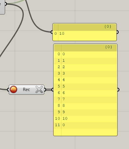

Everything works so far, but there is a Problem with the export of the images: I used animation controller by @fraguada to generate the images but, during saving the image counter seems to reset and because this value is used to drive the gh animation nothing happens.
Has anyone an idea why this might be?

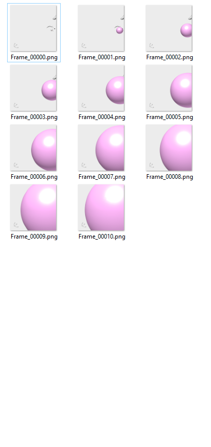

the ouput looks like this :
but should look somtthing like this: :point_up_2:

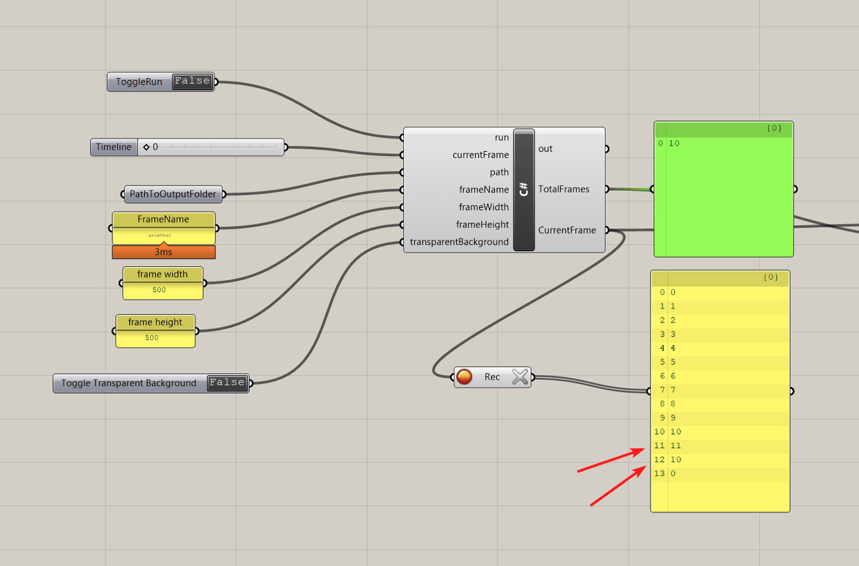

edit: also animation control outputs more frames than defined by the slider; which in my case calls the python script twice
edit2 : I modified the animation control script and it now outputs the right range; viewcapture is still empty though

I’ve tried the script in Rhino 6 for macOS and got the same result. The sphere isn’t showing up in the exported image files. I’m just getting the grid.

hm, I am really confused by this. See this screen capture. All grasshopper geometry is drawn in the rhino viewport, the data recorder shows no abnormalities but it doesn’t show up in the exported images.
even more strange when I set a static value to control the GH geometry it does show up, meaning it’s not a viewmode problem:
Yes, that’s the same result that I got yesterday. I recon there’s something wrong with the C# script. Either it used some kind of “exploit” to make this work that was fixed/updated, or something in the API changed and it thus doesn’t work anymore. It could be a minor detail, that doesn’t cause an error.

I think I figured this out – the problem was that Grasshopper computes the viewtoBitmap command before the preview geometry is displayed. To fix it send it to the top of the stack by selecting the cluster and pressing crtl +F (or under edit > arrange> put to front)
Credit goes to @DavidRutten, who answered it a while ago here.
