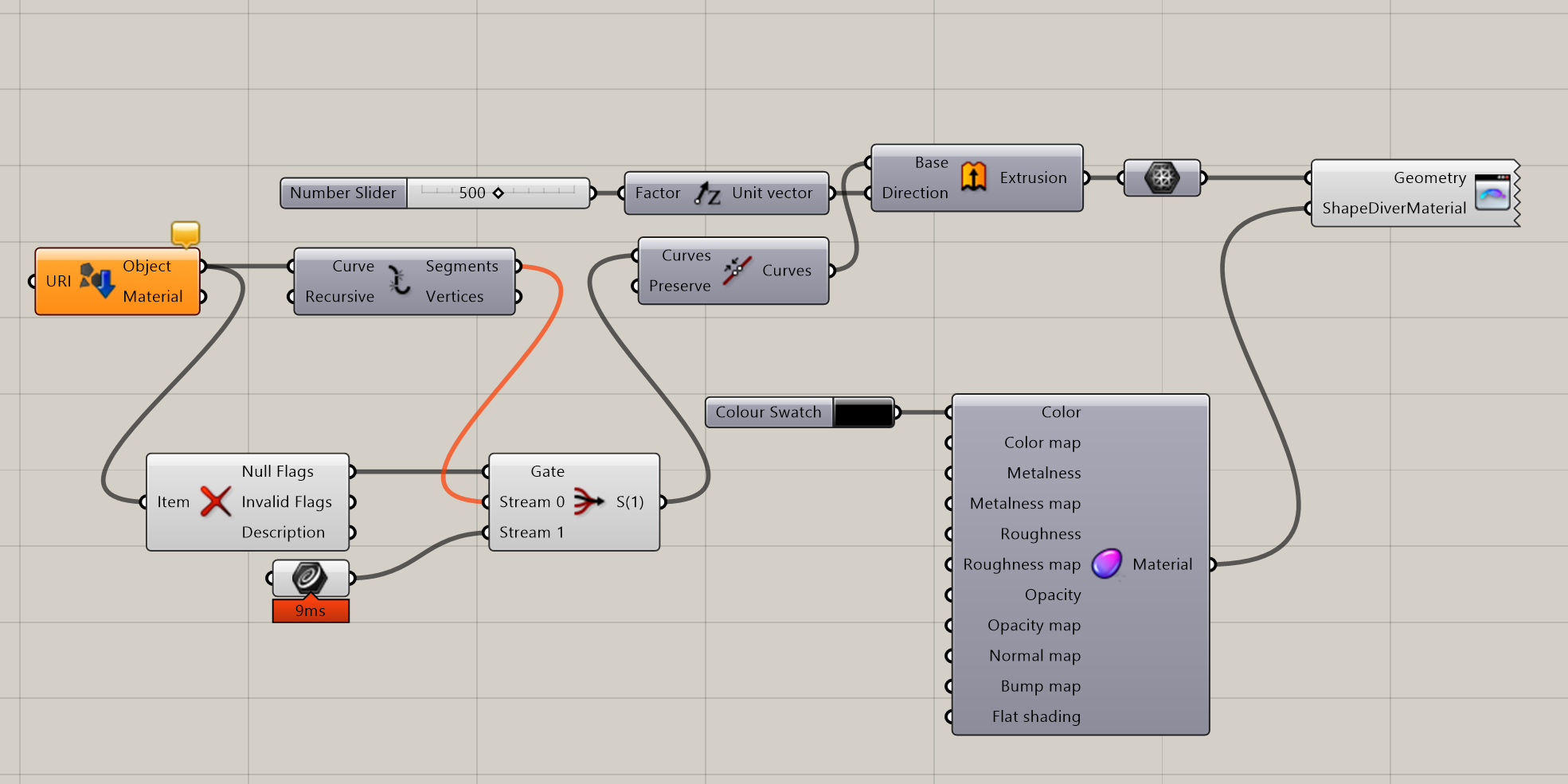

I’m testing how it works with uploading DXF files to Shapediver. But it doesn’t seem to work for me. I use Rhino7 and have a Designer Shapediver subscription. Still, I get an error when I upload the GH file:
The file itself is super basic…
Am I missing something?
Thank you already in advanced!
TestShapediver.gh (20.4 KB)
Hi Felix,
You need to switch your account to Rhino 7. This can be done from your ShapeDiver Dashboard, inside Settings, Account, then scroll down and select the R7 one. Once this is done, please try uploading your model again.
Best,
Perfect! That was the problem
