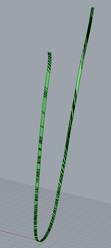

I have the problem that an invalid mesh is created from a closed brep.

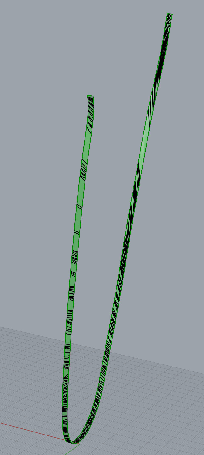

My goal in the Grasshopper code is to create ribs to stabilize, for this I used the contour component to create a curve in the shape of the ribs, offset the curve slightly and then between the two curves I created a surface (red in the screenshot). I then simply extruded the surface. I wanted to connect the extruded brep to the original body (green in the screenshot) so i converted the rib structure into a mesh, but I keep getting an invalid mesh, although I don’t think the rib structure is particularly complex. I have already played with the mesh settings, checked if the closed brep has errors, I have used rebuild mesh from Pufferfish and I am slowly running out of ideas.
I’m actually sure that the whole thing used to work until my computer crashed. I also deleted the Brep to Mesh component once today and added it again, then it worked briefly…
File removed at the request of the author
Maybe you have some suggestions for me.
Many thanks Tim
  1. Don’t use a Ruled Surface…
  1. Your extrusion vertically upwards creates a self intersection
What else? Loft works even worse
Give me a few minutes.
Wow thanks! A completely different approach.
nice!
…one more aproach: thought it might help to avoid curves, surfaces…
noCurves.gh (847.2 KB)
Also an good approach, thank you
