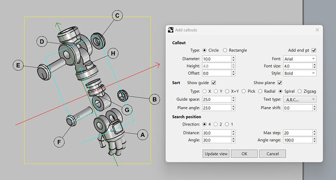

byRhinoGadget 1.4.2 Update Notice
The AddCallouts command has been added to Rhino. For those who couldn’t use the Callout component because they don’t use Grasshopper, this command will allow for convenient numbering tasks directly in Rhino.
Update to Version 1.4.2
Users who have installed version 1.4.1 should update to version 1.4.2, as it includes fixes for some errors in the AddCallouts command.

How to Use the AddCallouts Command
  • The AddCallouts command has been added and can be used in Model View and Page View.
  • In Model View: Select objects as usual.
  • In Page View: You can either pick objects one by one or select a Detail to choose objects within it.
  • Selecting objects one by one is useful when picking from multiple different Details.
  • The AddCallouts command icon has also been added to the toolbar.
