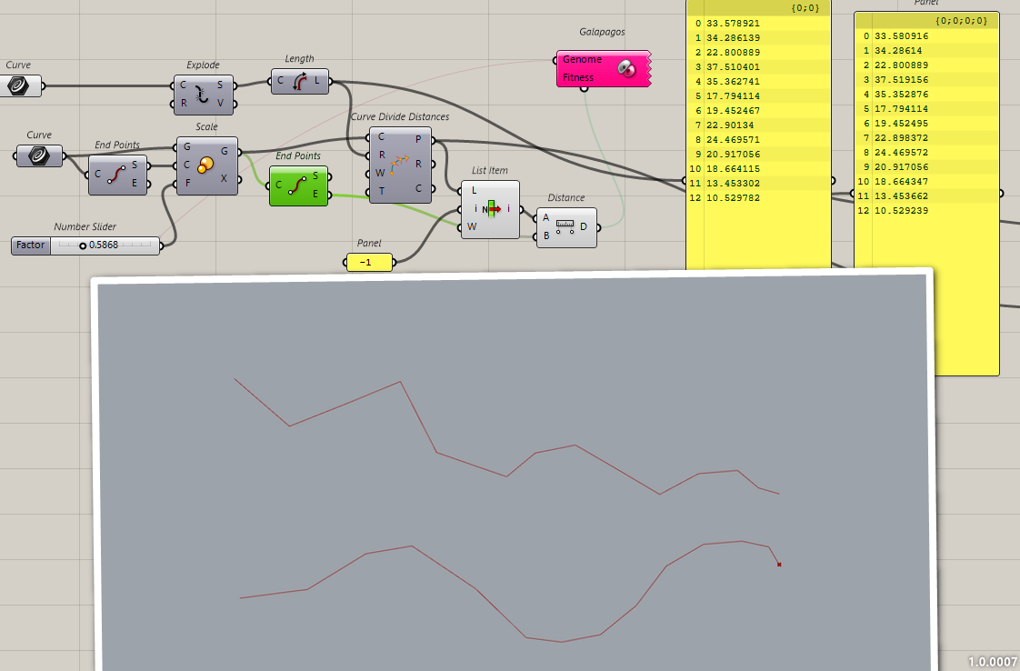

a bit late to the party, here a way of doing with curve divide distance and Galapagos.
Curve Divide Distance from Nautilus plugin but you can use
Divide Distance Multiple
I kept the distance from the original polyline, but you could get the other effect by scaling 1/0.5868
