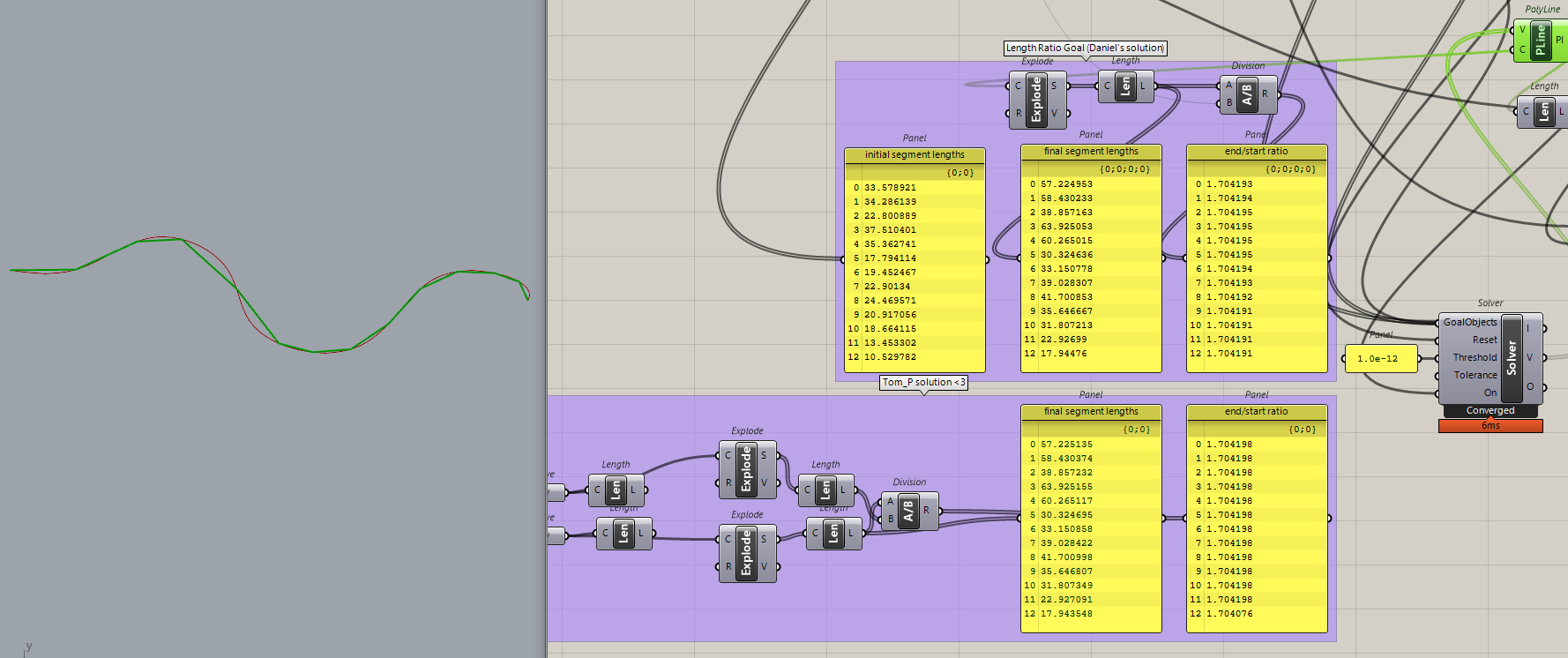

LengthRatio is the Goal you need for this in Kangaroo
lengthratio.gh (13.9 KB)
I need to study SO MUCH MOOOORE… :+1:
as speed/result comparison (@Tom_P )
Flow_scale_DanielPiker_LengthRatio.gh (30.0 KB)
thats it , correct!!! :slight_smile:
