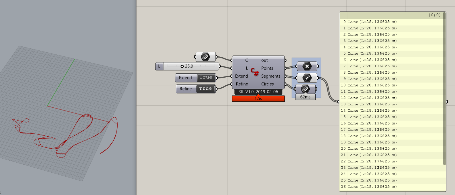

The code work perfect with 3d curve but in this example with n = 4 the segments are not equal.
equal dist kangaroo python.gh (11.7 KB)
also with a curve from solution of @RIL (n = 216)
Grasshopper freeze and with less count the segments are not equal when the solution of @RIL work fine

Yes, it’s easy enough to create curves with loops and bumps that are small relative to the size of the segments you are trying to divide it into where none of these methods will work.
I think there may also be curves/segment counts where absolutely no solution even exists.
The definition above that you say is freezing is your edited script with the counter and MaxIteration count removed. This is exactly why it was needed! (as explained in my earlier reply).
Running while loops with no breakout clause and with a condition that isn’t absolutely guaranteed to evaluate to true eventually is asking for trouble.
You can probably handle more of the pathological tightly kinking and looping cases with more checks on the parameter of the curve and choosing between multiple sphere-curve intersections (likely at some cost to the speed), but I don’t know if there’s any algorithm for this that would be guaranteed to work on any curve.
