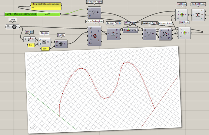

I’m looking for a way to produce the “best” polyline from a curve, using a given number of points. GH has a Curve to Polyline component, but it determines the number of resulting points. I was able to come up with something using Galapagos by comparing the total lengths of the segments compared to the total curve length and it fits my naive expectation that the points should cluster near the areas of greatest curvature, but it takes quite a while, and I have a whole lot of curves. Here’s the Galapagos attempt:
best polyline.gh (9.1 KB)
if you bake the new polyline and create curve you get different result compared to original
i tried with mesh
bake and convert to a curve than compare the new curve to the original one
But I’m not interested in reconstituting the original curve, just a polyline that approximates it.
what i mean if you want a polyline than the new curve must the same as the original one
if not so the polyline is wrong
best polyline_LD.gh (9.8 KB)
Here is a way it uses Curve to Polyline component (Legacy ?) with differents tolerances.
The multiple curves component
best polyline_multipleLD.gh (7.5 KB)
and here is a scripted approach that just takes a tolerance
splineToPolyline.gh (9.7 KB)
Thank you @laurent_delrieu and @lando.schumpich. Both methods are ingenious. Laurent, yours works well on any particular curve, but because of however Rhino determines the polyline, it does not have the effect I was hoping for. Small changes in the curve can have large results on point distribution, so when you connect them across curves with polylines, they are kind of jumpy. I am looking for a smoother transition that still has the points clustered near the areas with highest curvature…
Lando’s approach has the right look, but for multiple curves it gives different number of segments for the same tolerance. Laurent addressed this by searching over numerous tolerances, but again, perhaps this is not the right approach for my purpose. Maybe the “best” polyline is not what I need. I know, picky, picky, picky.
