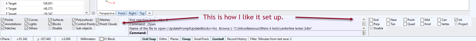

I dock my filters on the bottom left and my Osnaps on the bottom right. I’ve noticed multiple times that they trade places on their own. It’s not the result of a crash. I can place the filters on the left, close V6, re-open it and now they’re on the right side.

I see in your screencast, that you are running Rhino in a fully Maximized window.
Does it make any difference if you switch to a smaller non-maximized layout?

I’m using an Nvidia Quadro K5000. Here is the setup:
