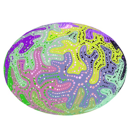

First virtual light for my new lamp design, some (many!) inspirations from @nervous.system with their Puzzle Cell Lamp but the generation of parts is made with my mesh clustering tool and the holes are done using my Fern Spores generator. Also I don’t know if I will make it in metal and/or wood. Here in France metal is quite the same price as birch plywood.

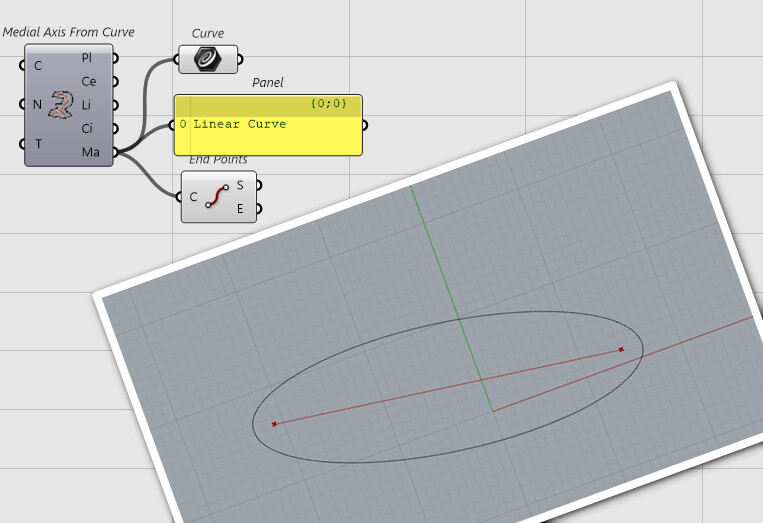

The base was the medial axis tool. I made a component to find an approximate of the Medial Axis. It is very classical and works with Voronoi but it outputs more curves.
The medial Axis made with Polylines that joins at the node

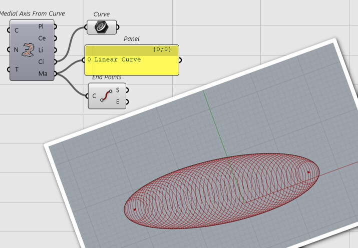

Approximation of the shape by circles

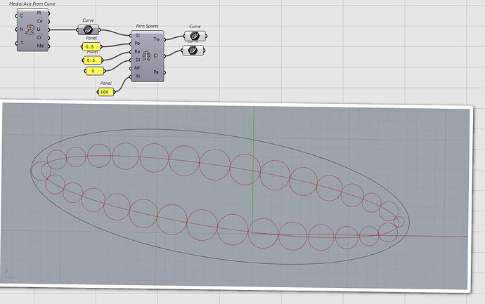

This “tween” curve is used to place circles with a radius proportional to the length of the ribs.
Here circles on “tween 0.5” and “0.5 radius” with no gap. As it is an iterative process, precision could be augmented using the “N”
Spacing could be changed.

First prototype of my Fern Lamp, here using variational cutting for the main cuts with tool from @DanielPiker.
I used 2 thickness of plywood to test, 1 mm and 1.5 mm. I also used to type of nylon fastener, rivet and canoe clip. It is half a success/half failure. I must think of some improvements.

I am very happy with the global design. I have another one with more sinuous shape (my own tool to cluster mesh).
With the size I made, Height = 400 mm, Diameter = 560 mm, the thickness of 1.5 mm surely the limit. But it is not the biggest problem. My main problem is that I was over confident that it will work looking at Nervous System work. It is a one layer assembly but as the pieces are not exactly on the original ellipsoid and as I choose the placement of each piece randomly and wood only bend, it was impossible to align all the rivets holes. This could work but not on an hyper static shape like an ellipsoid.
For my previous works with 2 layers I had more success but I also optimize more the shapes. It was a two steps process, rough shape than optimization to take into account the fact that parts are from flat material.
I think for one layer object I must use other way of assembly or less rigid material (metal plastic). For wood I could add laces, or links under the skin …
