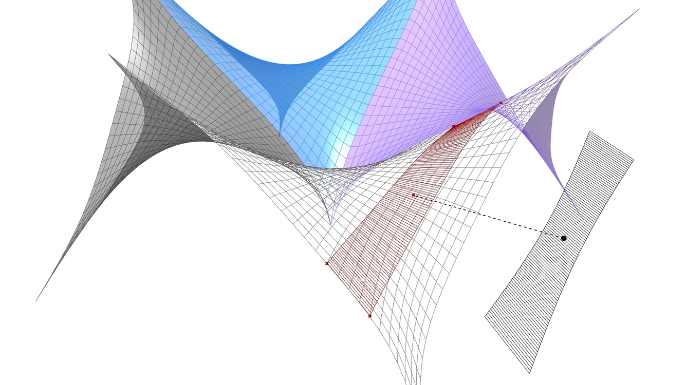

You can use the Stripper and Unroller components that come with Kangaroo to unroll quadrilateral meshes into planar strips. Some more options here (using geodesics and graph-based methods):

Here’s a sample that uses Anders’ method, with NJ’s form. I suggested breaking the mesh into quadrants so that all strips converge to pull points at their corners. This seemed logical to me.
Mesh Geodesic Strips.gh (142.8 KB)
One small adjustment I’d suggest to this is taking the strips diagonal relative to the isocurve directions.
This way they are closer to following the curvature direction, so the strips will be less twisted and should unroll with less distortion
@njwheele another way to experiment may be to intentionally use non-geodesic strips taken from the base mesh, since you’re not necessarily after precision, and may want to see how the paneling scheme influences your material form-finding. You can imagine breaking the mesh down into many different patterns - nested squares, L-shaped interlocking strips, etc.
The sewn-up results would no-doubt vary from your digital model, but if that’s welcomed, you could use this process to quickly model patterns and approximate the cut profiles.

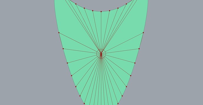

We started working with more organic forms, so structuring the mesh for unrolling panels has become a little more complicated. I have been able to draw polygons based from the same point and loft between them to create meshes with holes in the center (see EX 1&2). But, the base curves I have been using to create this new form are parabolas. Is there a way to find points along the parabola based off the points along the circle (or vise versa)? I need a set of points that allow for a more direct path from the parabola to the center of the circle, and create a panel that is closer to a trapezoid with the top and bottom edge being parallel.
Also, I found out that the fabric I am using (burlap) cuts nicely on the laser cutter. The laser cutter bed is 24"x48", so I’m hoping to find a way to keep the unrolled strips under the width and length confines of the laser cutter bed. For size reference, this structure will being around 12’ tall.
Anyone have any ideas? Thanks.
Form_10.28.2019.gh (89.3 KB)

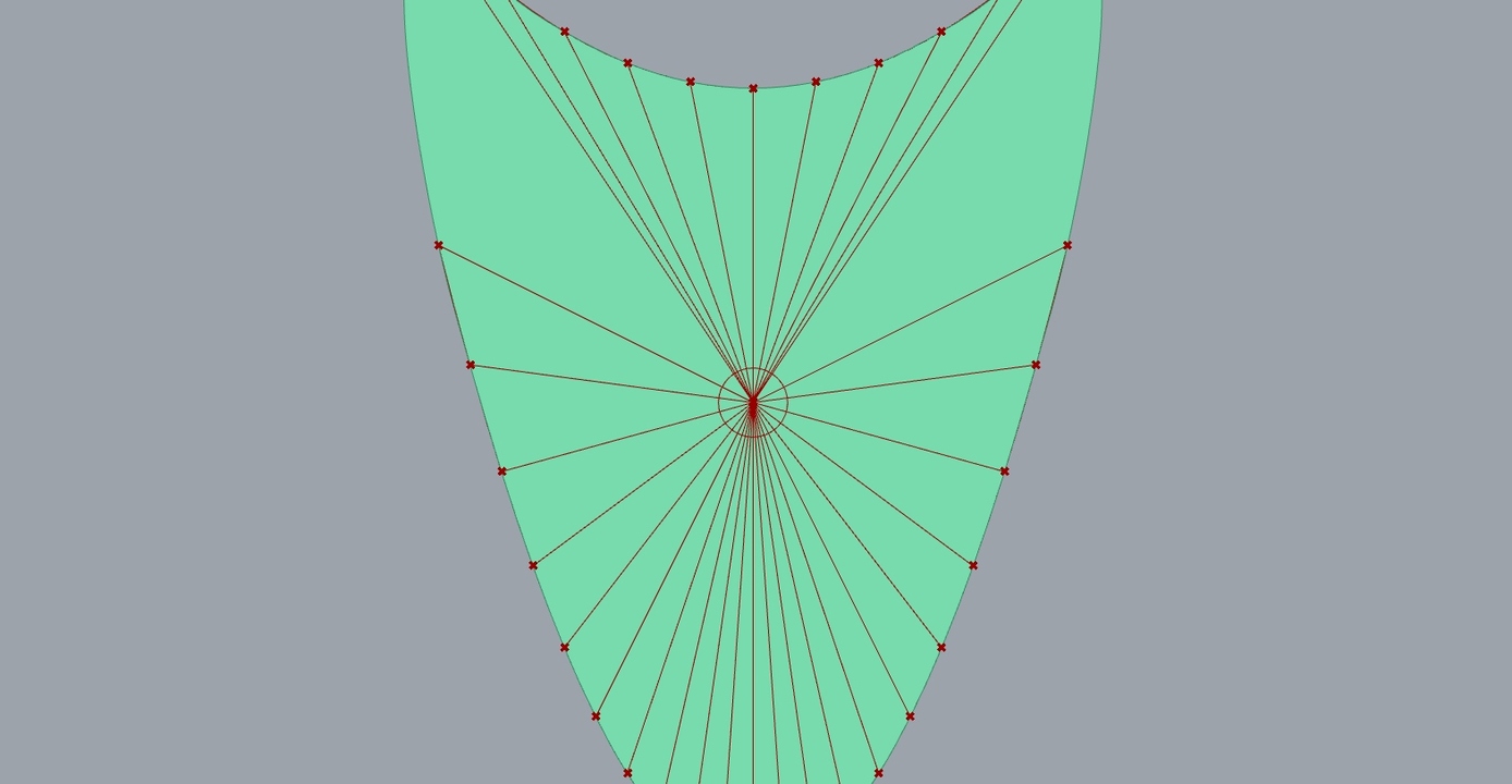

Here is what I have so far. I am trying to draw lines from the parabola to the circle.
Form_10.28.2019_2.gh (8.7 KB)
I think I figured it out.
Form_10.28.2019_3.gh (17.3 KB)
