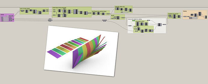

I’ve decide to design a little sail … but I’m having some problem flattening,my goal is cut the cloth.
I’ve tried squish , smash, unrolling… ( and some tries with grasshopper) … but i still have deformations , at the end, the sail flattened should get a barrel form … I can try to download the file if someone could help me. thank you for taking time to read!!

Since you haven’t uploaded a file i’ve tried to make something that looks similar to me here.
I have constructed the mesh specifically so it’s easy to unroll, from strips of quads. There is an inbuilt component in Kangaroo which will help.
If your surface is not developable then i’d assume you’ll have to use other options.
How have you modelled your sail? what are the geometric requirements?
Hope this helps
strips
unroll
mesh_unrolling.gh (24.9 KB)

Could you explain what you mean by the axis to unroll? The strips are created between pairs of curves in my example. I’ve done it “manually” using s lot of components to create the meshes as strips. This could be done with other add in “mesh loft” components. So the “axis” is defined when the strips are created. I don’t think the stripper or unroller let you control the direction. I

Oh I think, you mean regarding the kangaroo unroller direction? You can control it by controlling the structure of your meshes. If you provide strips of quads then it will unroll start to end.l. if you provide a mesh which has more than two faces to each edge, you’ll find you can’t control the direction. You do want strips right? Or do you want one piece which has been stretched?
