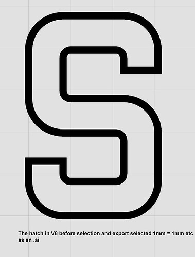

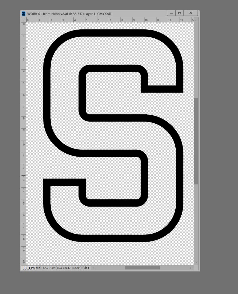

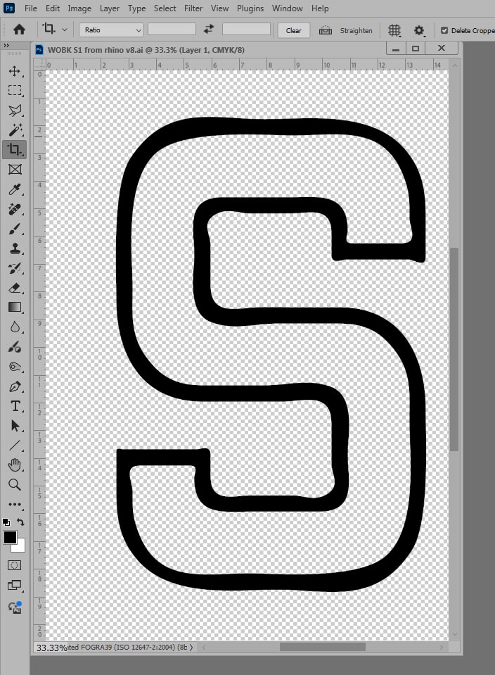

what is happening here, I have exported a hatch from Rhino V8 as .ai, open in Pshop latest as 20.5cm height, and its gone ‘jelly’ mode.
try again from Rhino V5, same.
try also Pshop CS6 and same again.
yet I have done a C, an F, an H and a B all were ok, no wobblies (just an annoying transparent border on mostly three sides (see other post) . all same method.
what is the solution ?

here is the file as source of all done so far.
why does the S fail ?

I suspect .ai doesn’t like your degree 2 arcs - most of which have 5 control points. You might try ConvertToBeziers on your curves, rejoin them before making the hatch then re-export as .ai. Don’t know if it will help though.
Edit: if all you need are images in PS, why aren’t you just using viewport captures to a PNG file ?
well I just had a Rhino update available prompt, so installed it, reboot pc,
and revisit the file, which I see I didnt save with the hatch done.
did the hatch, exported it again, saved the file suffix hatch
AND ALL IS OK NOW !!!
now… was that the update, or simply rebooting PC and launching Rhino again ?
