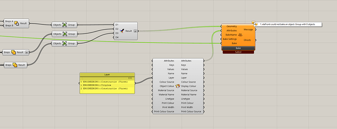

Im trying to bake multiple Breps which i’ve grouped before.
However elefront doesnt take the inputs and just says “can’t bake group with xxx items”
Whats going on?
Hey all,

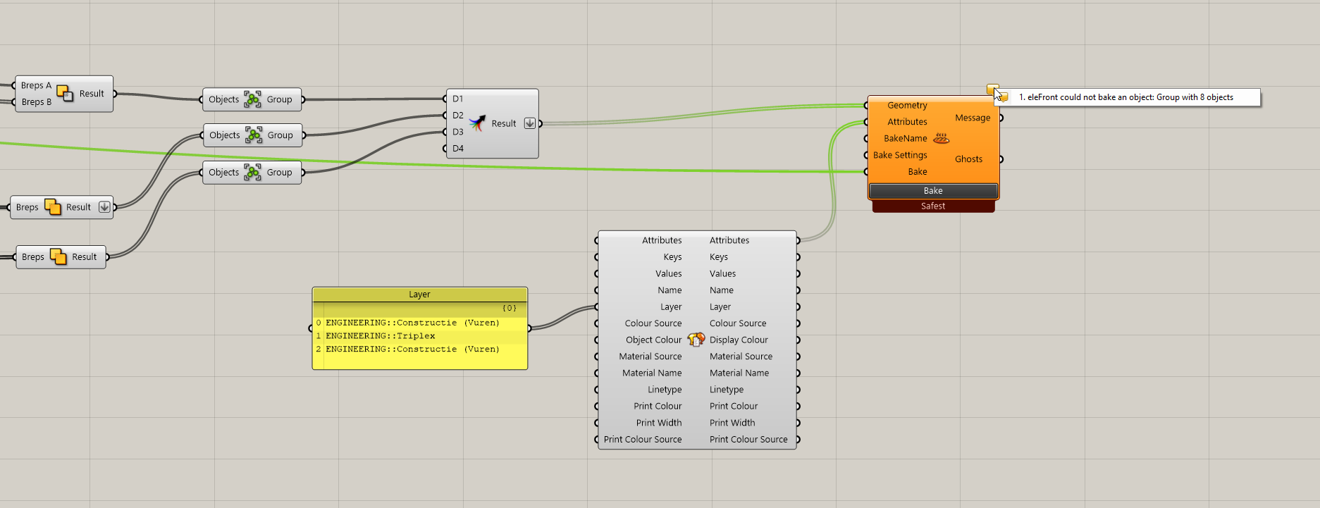

Whats going on?
Are you wanting the objects to be grouped together in the Rhino model once you bake them? If so, that’s different from the Groups that Grasshopper is referring to. To pull this off with eleFront, you need to check this item here:
Then make sure that your tree structure is set up correctly so that those items that were in groups are now instead on their own branch. For example:
It’s done this way so that you can create groups where the objects in the group can have different attributes.
Groups doesn’t seem to work with “Bake Objects to File”, am I right?
I’m trying to create a regular Backup of my Geometry in a newly created Rhino file with similar Objects grouped.
