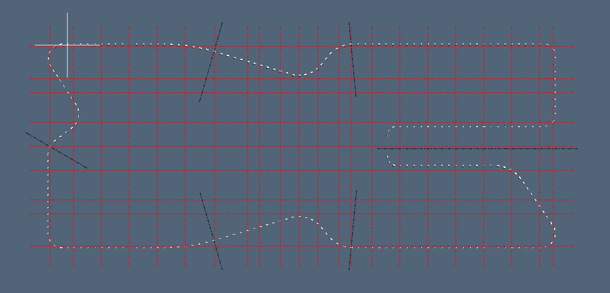

DWG Export Leaders Issue
Version: WIP(8.0.23010.12305, 2023-01-10)
Issue: Text Leader DWG Export
Details: The Rhino model I’m working with contains only lines and text. I select all objects on a layer and export them to DWG to be used as backgrounds for AutoCAD drawings.
After exporting to AutoCAD DWG, all the leaders are saved as MLeader that point at 0,0 despite them pointing at other things in Rhino model space.
Also, the MLeader line and text attributes are set to ByBlock instead of using ByLayer. (This is an issue with RH7 also).

AutoCAD 2022 and DraftSight 2023
*Both show the DWG files with problematic leaders.

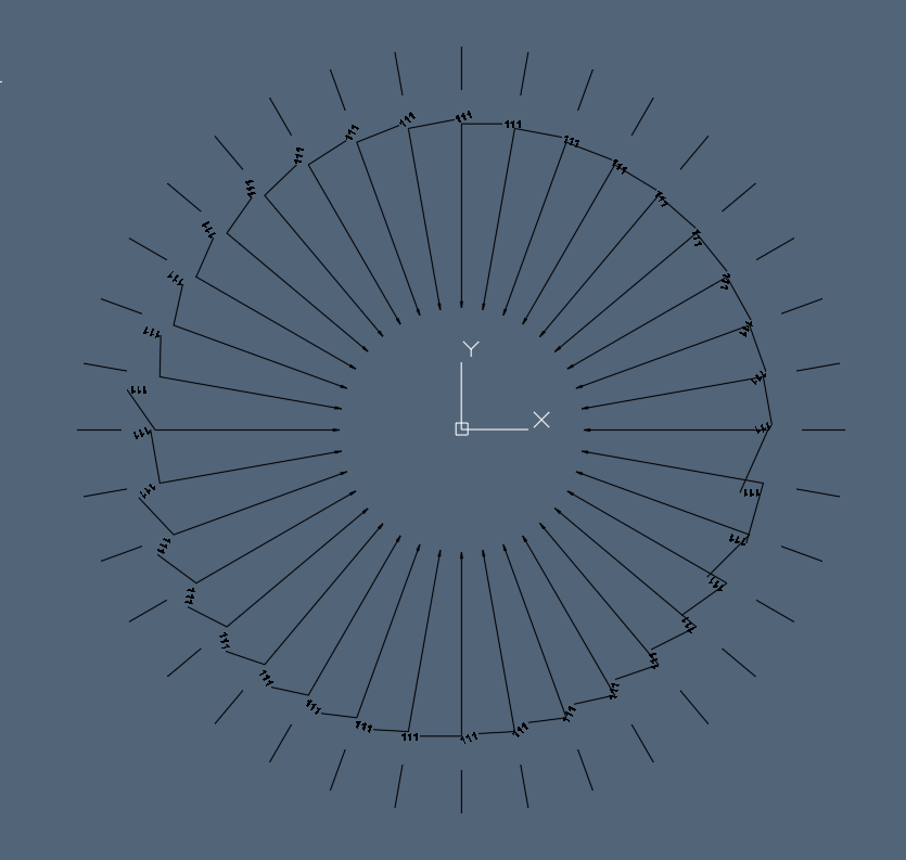

I made this quick testfile. The arrows on the outer rim are leaders without text.
Result Rh7 SR28 dwg export:
The text-less leaders start from 0,0,0 and everything is flattened. Inconsistencies with the leader line position/orientation.
Result Rh8 dwg export:
The text-less leaders are ok, except the arrowhead is much much smaller though both have the same style. Everything is flattened

There is still something wrong with leader export.
If you export leaders, they seem to work fine but moving them in Autocad makes their text orientate according to the leader line. And you cannot modify the Rotation attribute in Autocad.
Any help is needed if this is not a bug but just something peculiar with Autocad itself.

Hi All,
This issue is in progress as RH-73335
However, the issue is not with Rhino code, but specifically a bug in the I/O tool kit that we license to write DWG/DWF format files. Developer @tim is current working with the developer of the toolkit, and hoping for a timely resolution.
The issue is specifically with Rhino leaders with no text and how they are exported to DWG.
This is currently an open issue with DWG export from Rhino 7/Rhino 8 WIP.
It is not an issue with DXF export from Rhino 7/Rhino 8 WIP or Rhino 6 DWG/DXF.

Hi @mary,
I would like to also emphasise the “flattening” issue of the leaders. The Z-position of the Rhino-leader is not respected in DWG export.
@Toni_Osterlund
I see it now.
Lines export at the Z elevation.
Leaders are on the construction plane or flattened.
(harkening back to the old AutoCAD FlatLand variable!)
This has been logged as RH-74308/Leader-Elevation-is-not-Bring-Exported-to-DWG-DXF
You will be notified here on the Forum where there is a fix.
