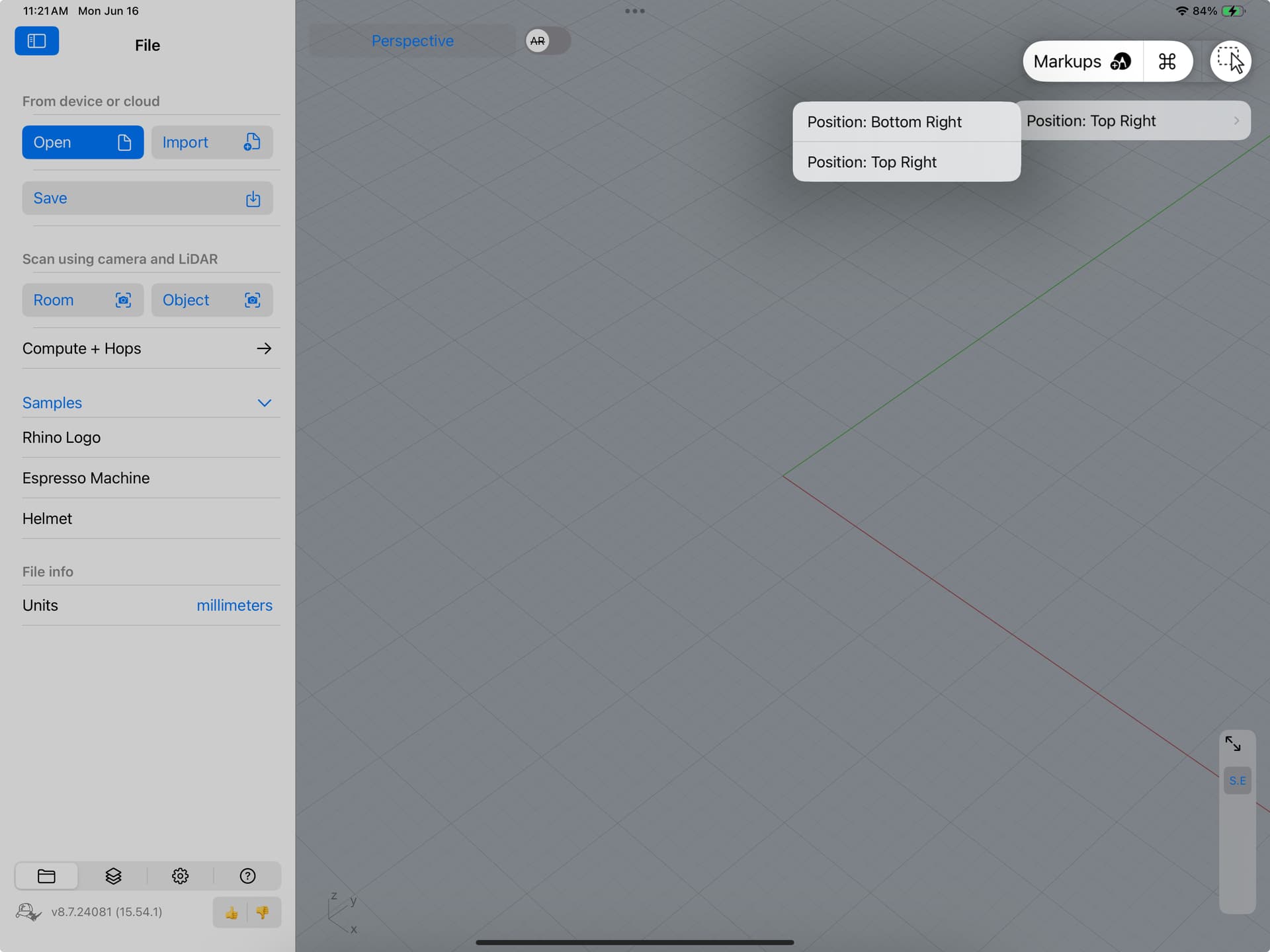

You can do that now, Long press the area between command icon and the selection tool, select top-right from the menu

First, I didn’t realize I could move the command bar so that’s my mistake. It’s much more clear having it at the top. I guess this leads into my question about iOS 26 and the UI. My point was more that with the addition of the menu bar and a real cursor, would you consider a UI that is closer to the desktop Rhino? So a set of command tabs along the top, a typical File, View, etc command bar, and so on.
