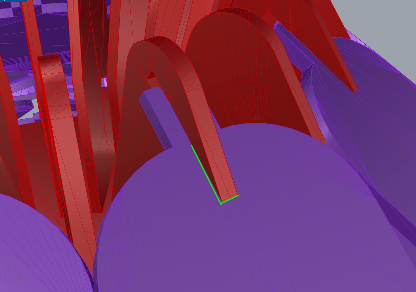

Is there any way to change the type of fit between the pieces in an automated way? I want to make a combination between the original fit and a fit like the one in the image below, making the external sheets and the internal slats have a tear, one fitting into the other. exactly between the red slat and the purple sheet where there is a green mark, this on all the sheets.
1c88cba198d283dbab974e1c7c3081dcccdb121f_2_690x483
Thank you
