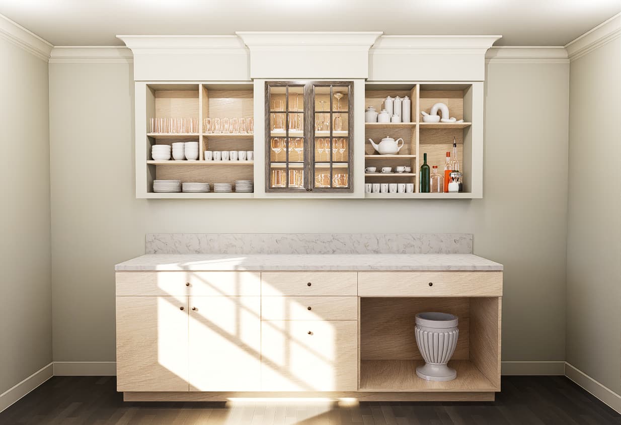

We need more models! I’ve become extremely fast at modeling junk… unfortunately that doesn’t really make you a better modeler. It also makes you very uncompetitive if you’re rendering scenes if you have to model every last little trinket. My end goal here is to have assets packs built and ready. I’m going to try and fit as much stuff as I can and still be able to upload to F4R. I’m trying to keep things as clean and organized as possible but much better than this means nothing would ever see the light of day. File size(s) balloon fast and I’m searching for a cause/solution to that. I might break this one apart and upload it in pieces. The user can then just compile it back together by importing.
The (clear) glass looks terrible in these first two renders. I started to play around with it but the AI enhancer is what really fixed it. I’m also playing around with the lighting inside the glass door cabinet (practice for an actual real paid job :smiley: ) - it’s challenging but I’m learning. After I switched the “show in reflections” option off for the strip lights (I’m rendering in D5) things looked much better.

Everything is rendered in D5. This one uses the ‘AI Enhancer’ settings all the way up! It did pretty okay I think:
Not without the odd glitch though - drawer face just below the counter and this (oops!!):
It really knocked the glass out of the park though and that’s what I was struggling with the most - getting the glass just right. The renders could be a lot better but I have much more important stuff to finish up. Plus the whole point of this is so that people have more time to render and spend less time modeling all that small junk!!
I’ll be looking for suggestions ranging from how the file is organized all the way to the modeling itself. Do keep in mind I’m somewhat stuck in my ways - not so much out of stubbornness but rather time/ability/energy related factors. Plan is to upload free stuff to F4R and cheap stuff to Gumroad or a similar site.
Still struggling with the glass a bit. Part of the problem is my lighting though. The settings I’m playing with are specular, roughness and opacity. It’s a very delicate balance!
