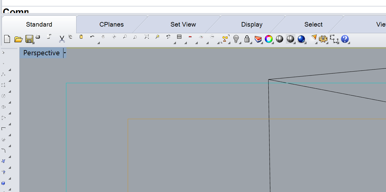

Menus and Command Line are now truncated:

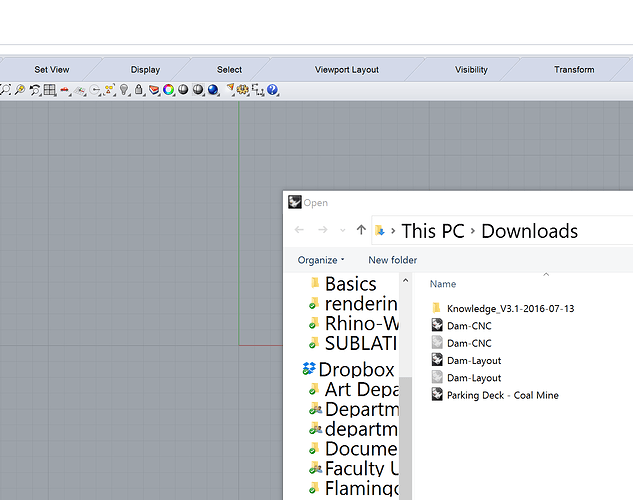

Aaaaand, when I go to open a file (a quick check shows that Rhino is the only app that displays text so large in the open dialog - PS and Chrome display normally):
edit: after restarting Rhino a few times this seems to have cleared itself up…

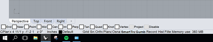

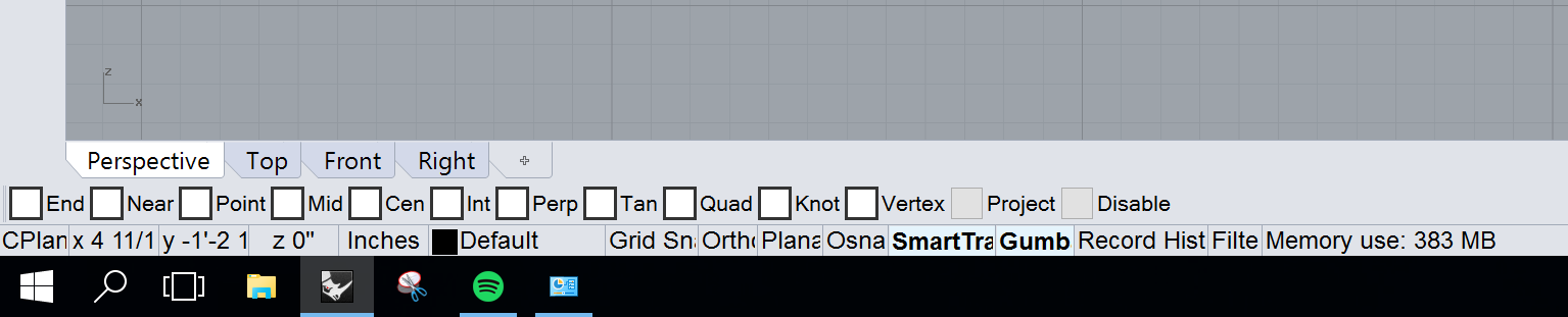

everything looks better now, the only oddity is at the footer:
In Rhino Options > Appearance, set your “Text size” to 9.
It is at 9. I also tried setting it to 10, however this did not cause the ‘cell’ around the text to resize.
-b
Try 8 or 7. You might have to restart Rhino depending on how “responsive” your display drivers are.
