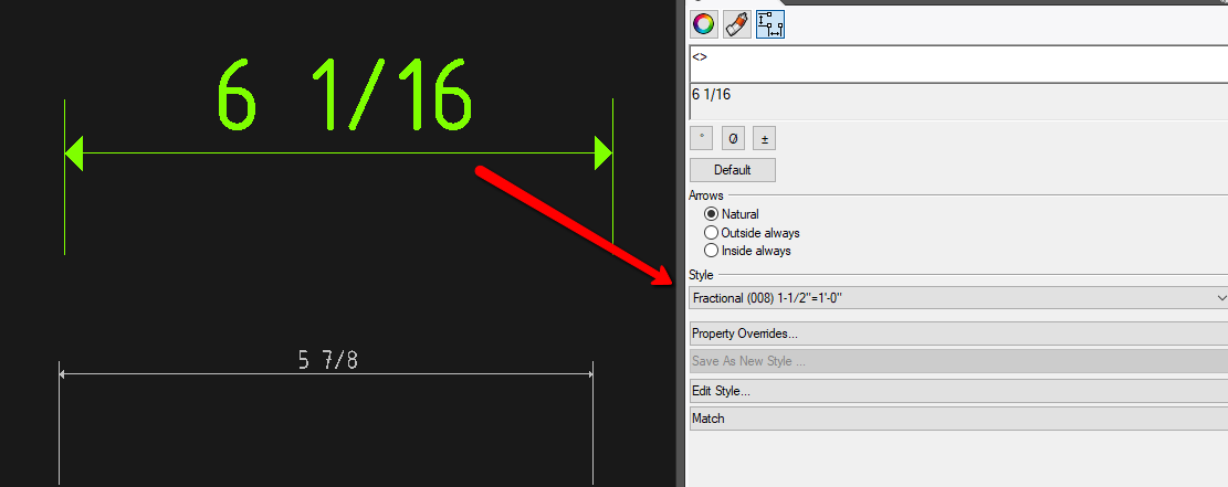

Check this out. Basically Model space scaling is fairly useless to us or any other architectural drafting workflow, just because model space scaling doesn’t scale the dim text offset. If it did, we wouldn’t have to have this:
We’d have exactly One architectural style and One fractional instead of the whole scale list. Just because dim text offset is different from scale to scale.
See here:
