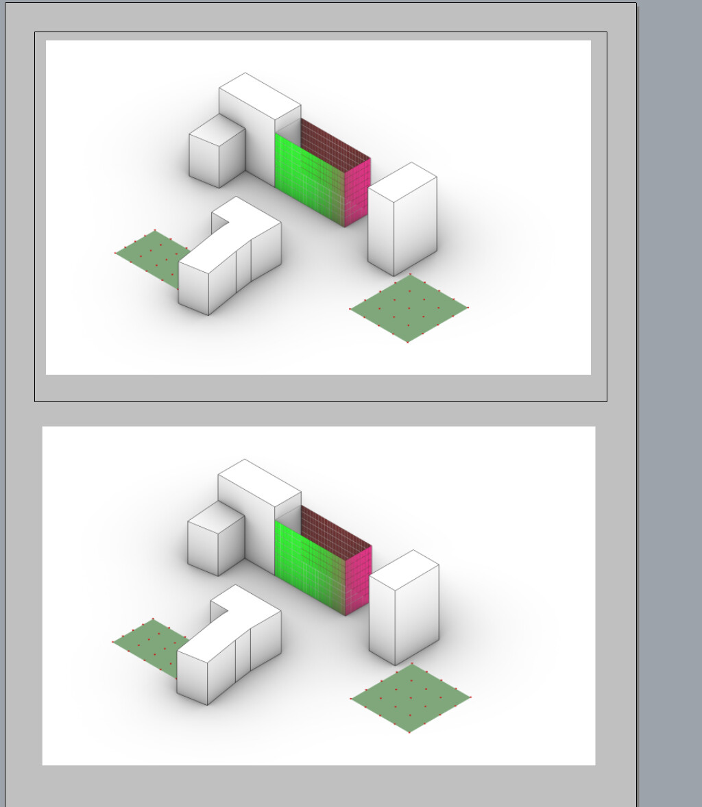

Hello - does the rendered mode show differently in model space? Can you post a simple example file?
Hi, I uploaded the image.on the left, image is general perspective view mode.
on the right, image is page layout which added detail perspective view.
default gamma setting 2.2 in Rendering option might be automatically disabled in page layout.

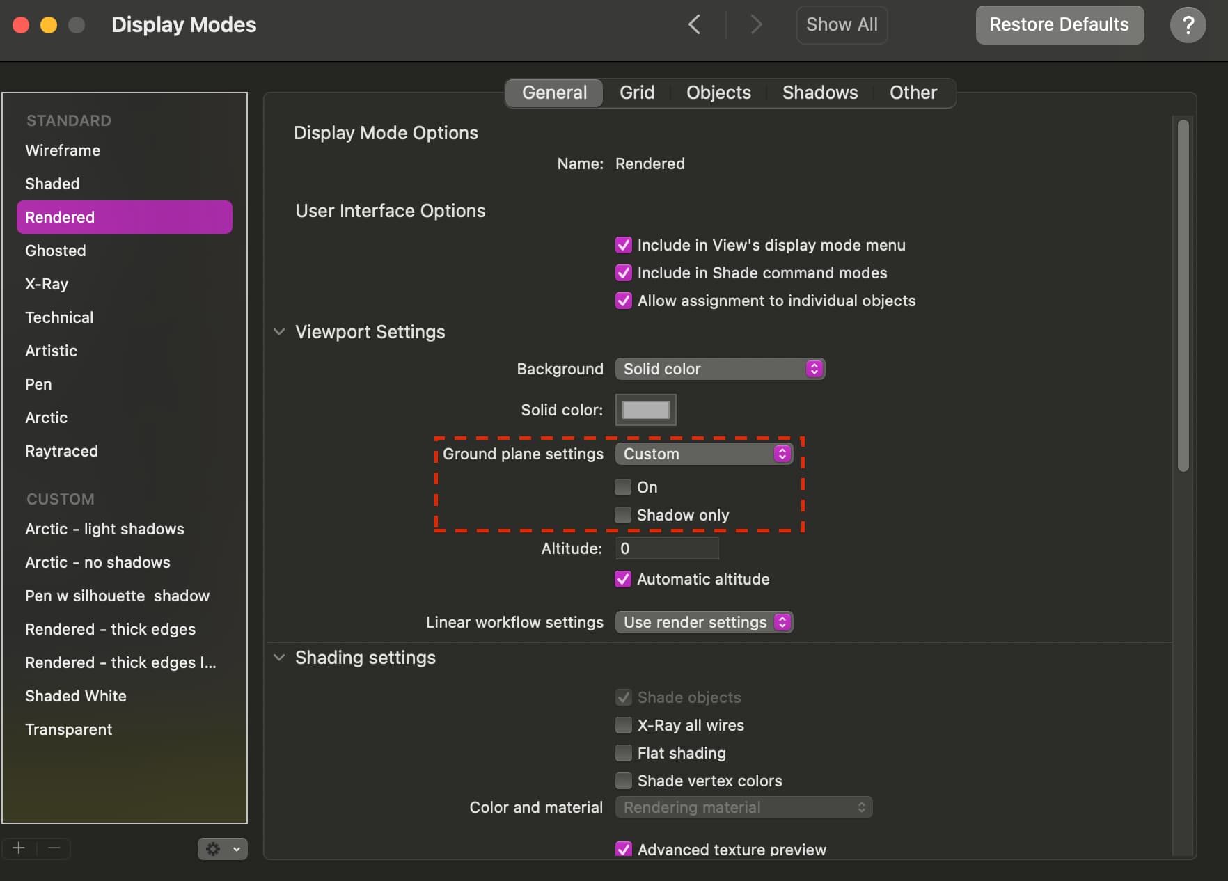

Hello - try setting the ground plane to use a material.
Hi, I’m having the same issue and cannot find a way to set the ground plane to use a material in the display mode settings. Also, I don’t see how this will help? I definitely think it’s to do with the Gamma settings in Layout Mode.

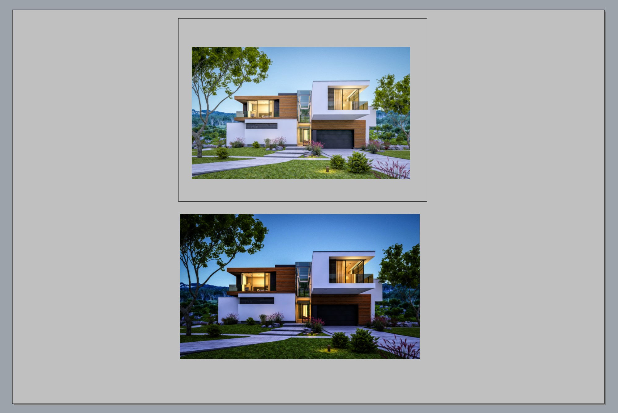

Bumping for visibility. Having the same issue in Rhino 8. Wondering if it’s a graphics card issue.
Please run SystemInfo in you Rhino command line and post the result.
Screenshot of difference in brightness: Top is a detail view of the same image pasted in model space. Bottom is directly in layout space.
