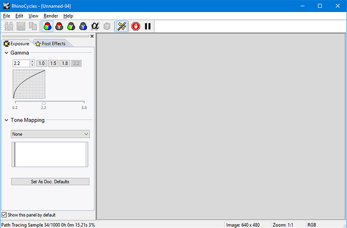

Raytraced display mode works fine, but render command render just grey image.
Ugh, I created this YT item to track the progress. Thanks for reminding.
Upshot of having Cycles For Rhino bundled with the WIP is that I know have to pay more attention to the modal renderer :slight_smile:
/Nathan

i had such high hopes this morning, because i thought i could finally be us cycles as in normal render mode again.
but no :sob:
like @FOI
EDIT:
but on the other hand there is one huge improvement in usability. changing the color of a material in raytraced mode was freezing rhino and made it practically impossible to use. now that is solved. great!
:confetti_ball:
