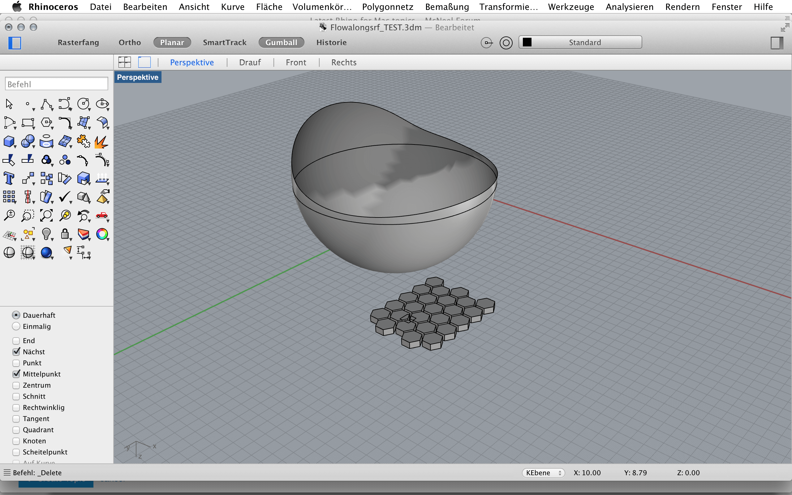

i want to project a honeycomp-pattern into a spherical/dome shape. The pattern represents the inner-structure for a helmet.
Now that the panelling tools are no longer available for the mac version, i have no clue how to get the pattern into this shape. Flowalongsrf doesnt give me the desired results. It always distortes the pattern. Array on surface isnt precise enough. Can anyone show me way to get it right? Otherwise i have to look for another 3D software…
