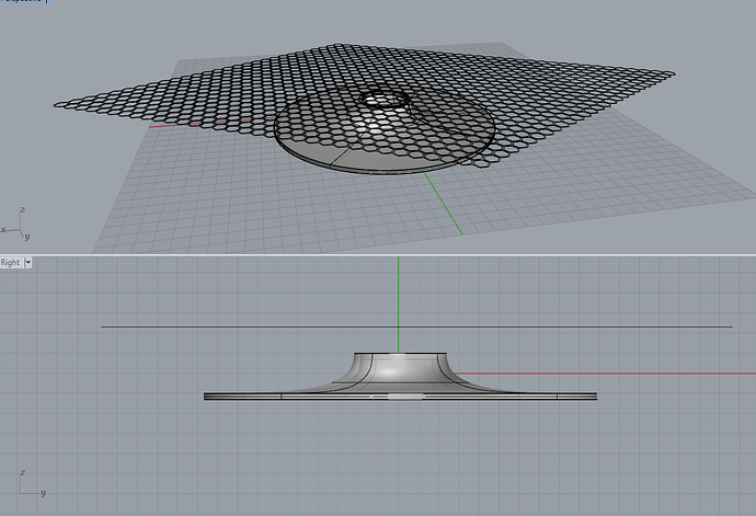

Ive set myself abit of what feels a difficult task, ive created a vortex type shape, and ive alos created a tesselated heaxagan pattern, im simply tyring to wrap that pattern around the under side of the vortex, ive tried flow, flow along curve, surface etc. with no joy. i dont suppose anybody has any usefull advice? :smile:
so i basically want the pattern to form straight down and around onto that curve
thank you again
Io if flow doesn’t work for you, did you try to project it?
Im finding that no matter which asect of the model i click, it just wont do the right thing, project appears to do nothing…
Don’t know why project should not work but you can kind of simulate it: extrude all your hexagons so they extend over your form. Then calculate intersection lines.

First thing I’d try is figure out why project is not working for you. Are you able to project just one simple curve, one hex say, onto a simple surface? If that is not working then something is definitely ailing your Rhino.
Next, how exactly do you want that pattern placed on the surface? Mathematically speaking, you must know any fixed pattern will have to distort in order to fit onto that shape.
I’ve attached a rhino with a few samples. The flow sample shows how the hex towards outer ring will have to expand in order to meet. The project and pull samples show similar issues with stretching.

Hi thank you very much for the detailed responses, im just trying to experiment and figure out what is the best tool for the job in rhino and i think project appears to be working.
thank you for your help
