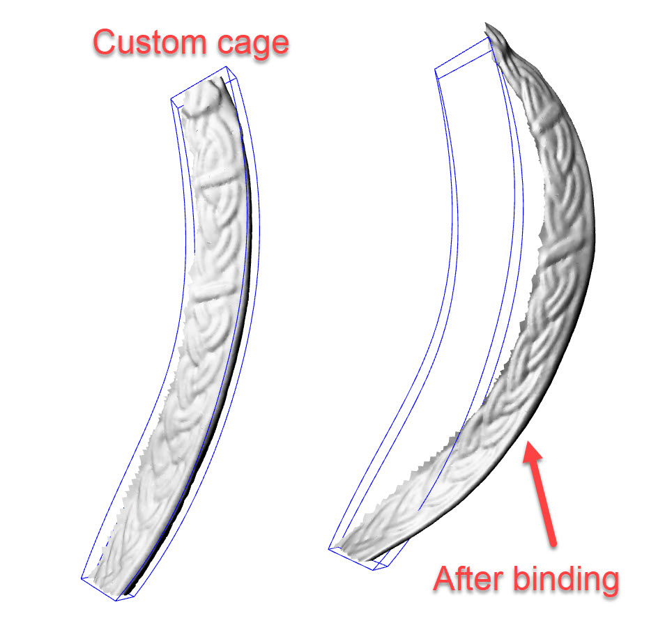

Hi David - the using pre-deformed cages is on the pile - a long-standing wish - I do not know if that means it is hard/impossible, or there is not enough clamor for it.
RH-2584 Pre-deformed cages do not work

@pascal I think I must have imagined this had been fixed - see below. I flowed a cage object I created with the Cage command, with Flow. I use it as a selection for a control in CageEdit command, and it performs the deformation made on the box so far (even though it has not been a control before). Was it something similar that was fixed?

It makes no sense to try to morph a banana with a rectangular cage.
I guess that cage edit would be perfect to edit Spongebob squarepants, but for most of the shapes youâd want to edit in Rhino, itâs just not very practical.
Iâm quite late to this conversation, but it should be rather simple to create a workaround by constructing an inverse cage. the idea is this: you have an object, and you create an independent cage C. you fit that C to your object, and and then you create an inverse cage C_inv that basically inverses any translation of the cage points. you then apply C_inv to your object and it should theoretically âboxifyâ your object. Then apply C to the boxy version of your object which should bring it back to its original shape.
