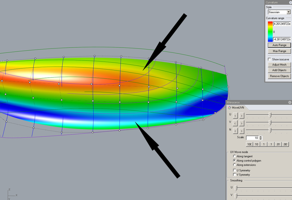

I’ve got a feeling the ‘wish’ pile has got a little low, so here are a couple more to top it up…
  1. Could there be a transparency slider for the coloured curvature analysis? This could allow us to easily ‘see through’ the coloured surface and select control points.
  2. Could the specular highlights be removed from the surface? They tend to get in the way of viewing the colours and can make some areas look as if they are distorted slightly when they’re not. Of course this is solved by rotating the view so the highlights move to a different place, but I just feel they’re not needed in this situation and are not adding anything to the analysis.
See images below - first image shows what could be interpreted as possible surface distortions, second image shows model rotated and looks fine.
Many thanks!
