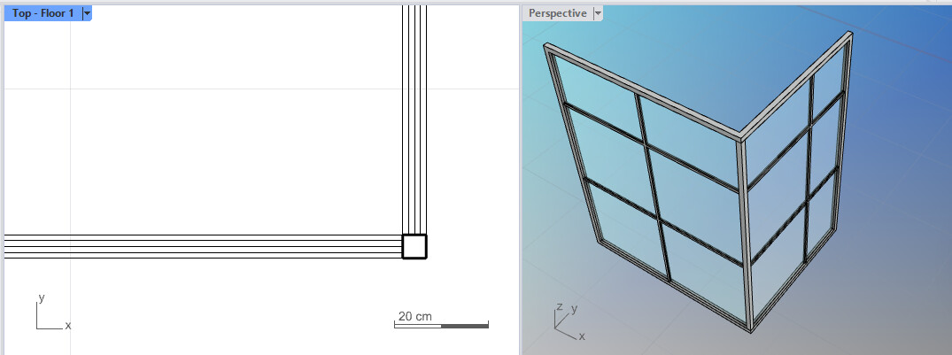

Hi guys,
New to VA. I’m exploring the curtainwall function and I noticed that the curtain wall does not create a proper corner (i.e. 90 deg corner) Normally a corner will use a single corner mullion. VA creates a double mullion at the corners as if it’s 2 different systems. See the image below.
I’m trying to achieve something like this instead

Hi @biz Unfortunately curtain walls in VisualARQ don’t solve the intersections between two objects, and they are not that detailed to achieve that kind of mullion for the join at the corner.

How sad. I don’t need to have that kind of detail, but a corner mullion(in a simple geometry) could be very useful. Any plans for that in a near future?

This feature is in our wish-list. We need to study how much time and work it would take us to carry it out. I’ll keep you posted.

Hi, there are no news on this feature. You can draw the corner mullions as columns, vertical beams or just using extrusions. Of course they won’t be linked to the curtain wall positions, but that’s what you can do as a workaround so far.
@biz @e0684040 I let you know that in VisualARQ 3 we have added automatic joints for curtain walls. It’s quite basic: it joins the mullions and frame of different curtain walls that have coincident ending points, but it doesn’t provide construction details at the corners. So it doesn’t generate a corner mullion like the one in your screenshot, but at least you don’t have overlapping geometry now:
