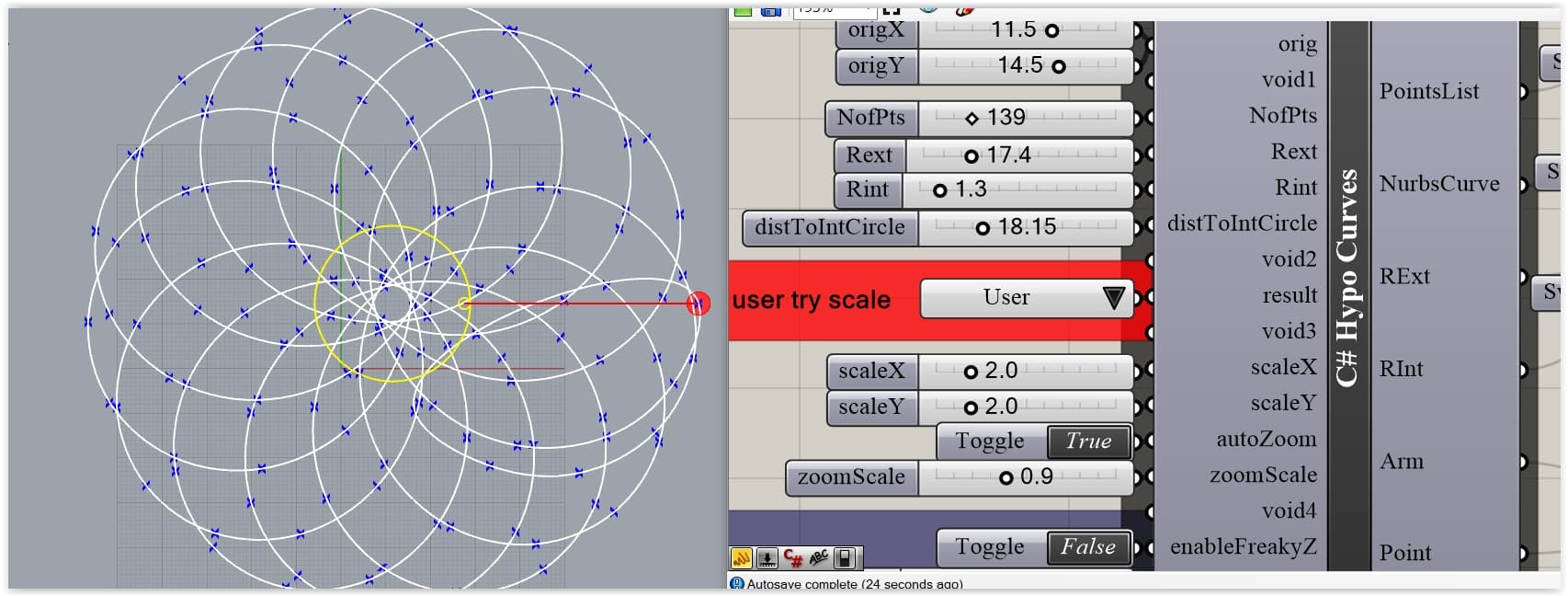

Spiro/Hypo Crvs are very easy to do using code (components/add-ons/etc are not my game - at all). If you want an indicative C# on that matter notify (but if you are not willing to walk that walk … well … it could be a bit useless to you).
See a very simple take:
And the maths for the above:
https://mathcurve.com/courbes2d.gb/hypotrochoid/hypotrochoid.shtml
