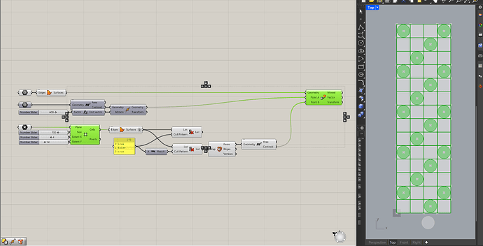

I’m struggling with 2 things here:
  1. Creating a checkered pattern on a surface grid. What I can’t figure out is how to select every other cell in both directions (so it alternates by row and column, like a true chessboard).
  1. Subtracting circles from the grid. How do I subtract those circles from the grid cells (so each cell becomes a frame with a circular cutout)?
I’ve attached my gh file. Please let me know as soon as possible,
File 1 Help.gh (16.3 KB)
Thanks!
This?
File 1 Help.gh (17.1 KB)
Yes this works! Thanks so much!
Without Surface Split, and the ability to switch between even and odds:
File 1 Help VR 01.gh (14.9 KB)
Or maybe I misread, and a single surface is what was desired:
File 1 Help VR 02.gh (23.6 KB)
