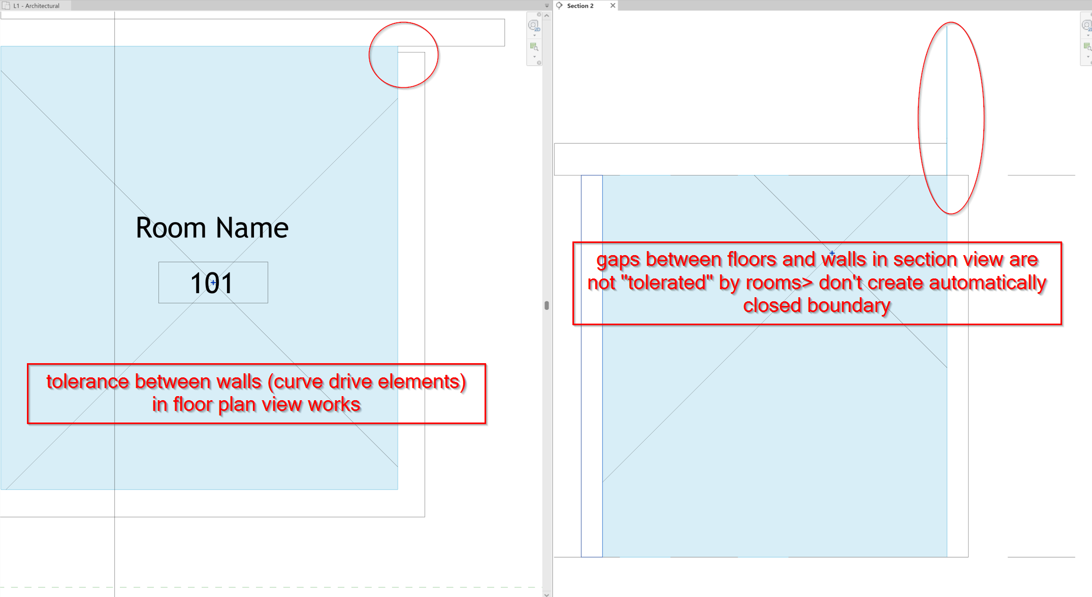

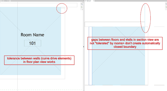

Is add room fault tolerant ?
There are a number of similar requests in this regard.
https://www.autodesk.com/support/technical/article/caas/sfdcarticles/sfdcarticles/Tolerance-of-room-space-bounding-elements-at-floors-walls-in-Revit.html

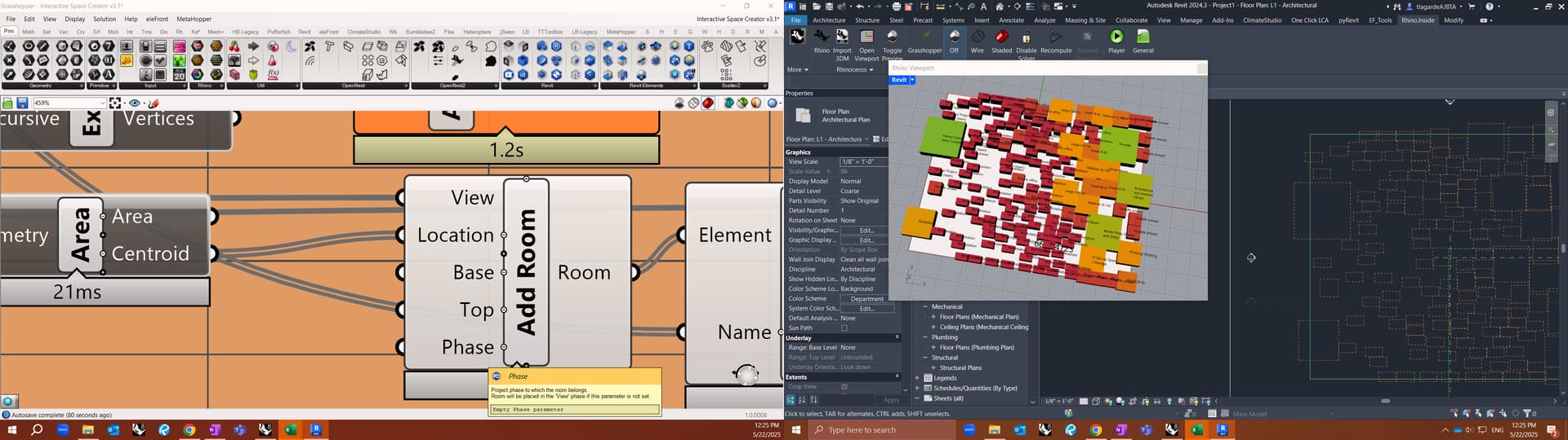

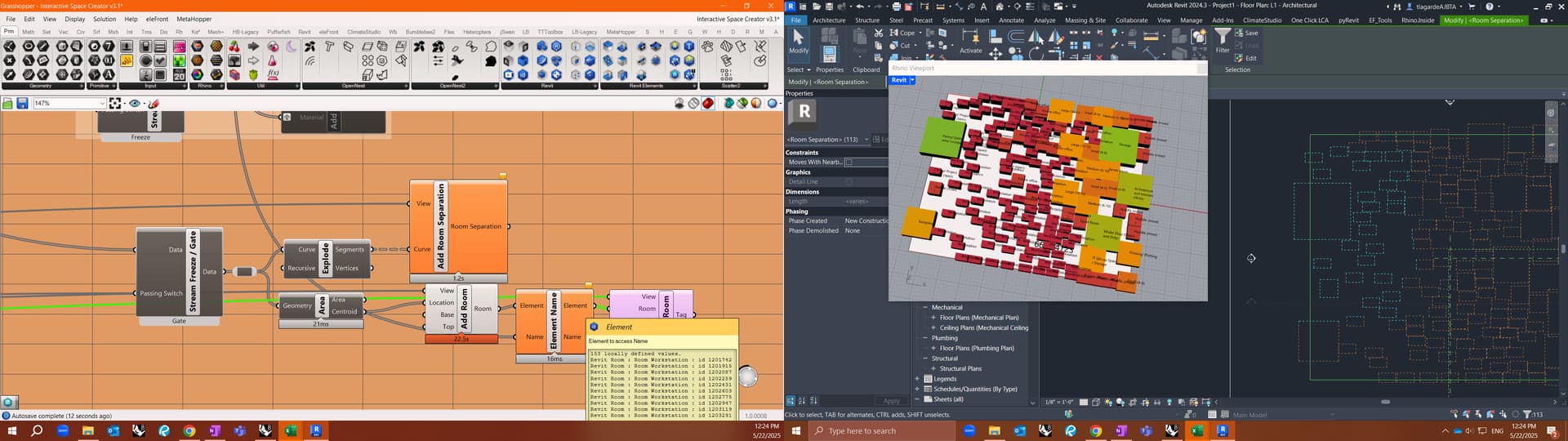

I think my problem is specific to the way my data has been organized, I will share something soon. As usual, super fast, thank you

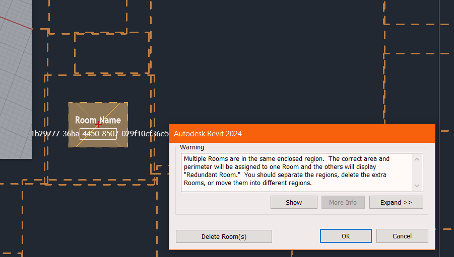

So, here’s what I have
It seems the right are created, they just don’t show up in Revit, can’t explain that
Are they going in on the correct Phase? (is the Phase visible in that view)
I didn’t set up any phase, everything is by default, new project
BTW, this input should be showed by default
Looking at the orange separation lines overlapping this is going to be a challenge
